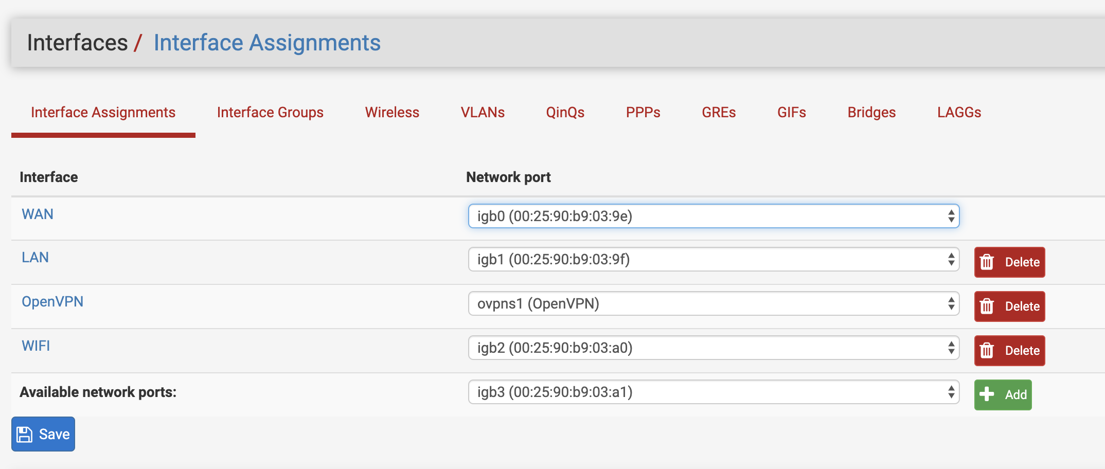

      I installed pfsense on a physical box and set up a LAN interface and a WIFI interface like so:
      LAN and WIFI interfaces work, I attached a switch to the LAN and a Wireless router to the WIFI. Both the clients on the switch and on the wifi router are connected and can browse online.

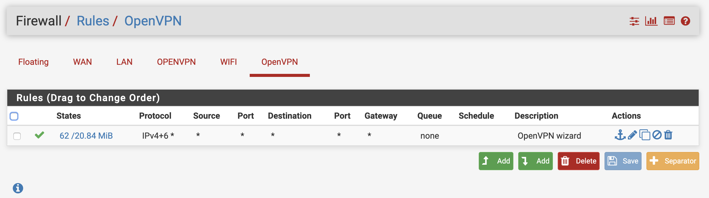

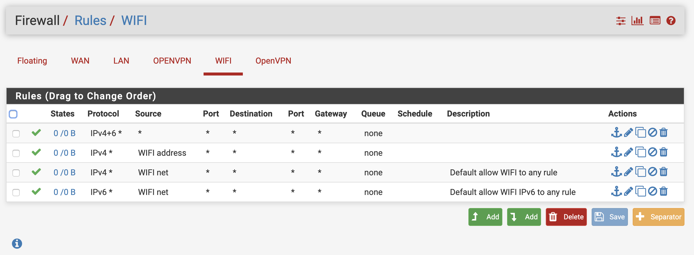

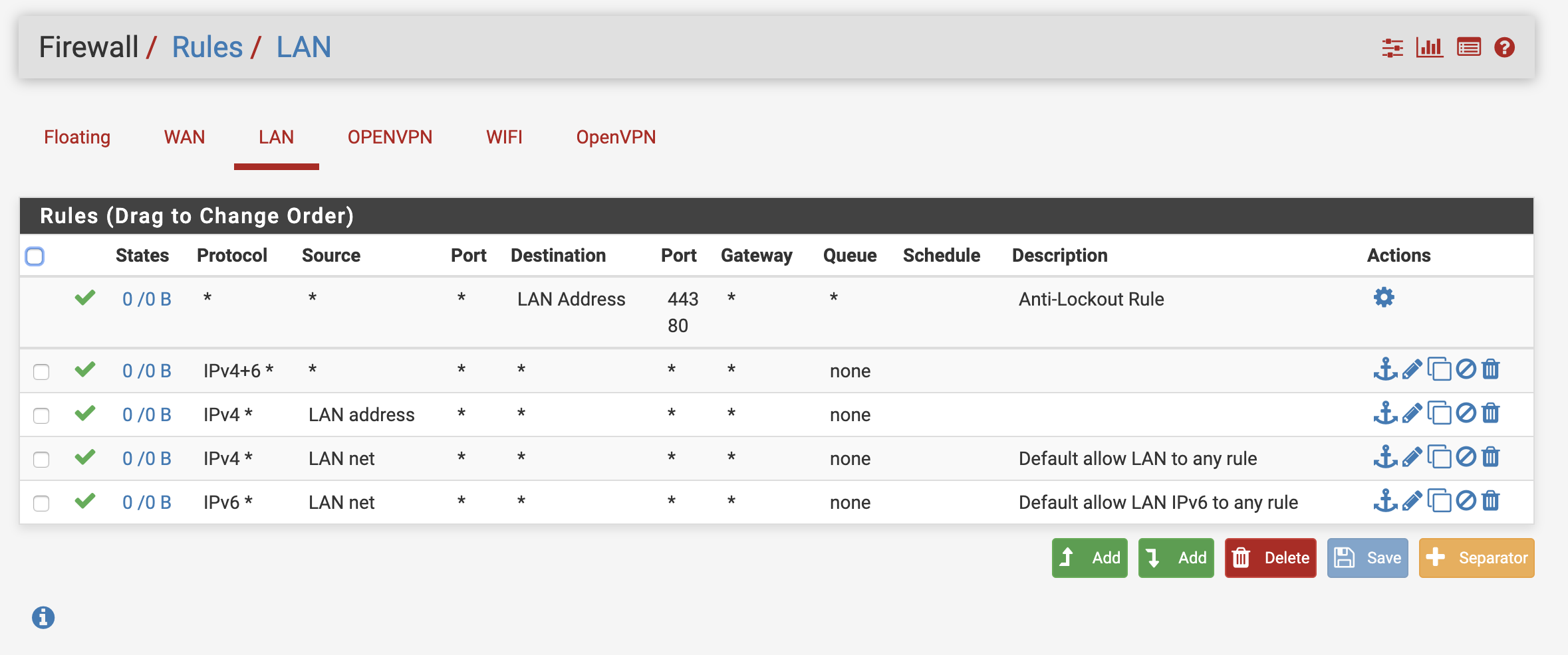

      I have only the openvpn port open on the WAN, for the rest everything else internally is open (please don't mind the redundant rules):
