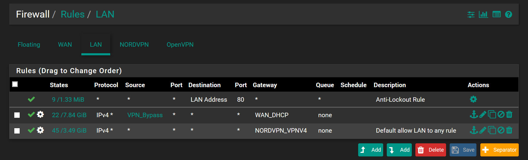

      I set up my pfsense router last week, and I managed, with the help of the community here, to get it up and running, and get my VPN set up.
      By Friday, I had everything working great. Initially, everyone was blocking me from streaming because of the VPN, but I created an alias and a rule for the "smart" TV and for the fire stick on another TV, so I could bypass the VPN and stream TV over the WAN

        mine has worked like this for years with multiple vpn tunnels going
        firewall > rules > lan >
        wan.jpeg !

          I tried to copy that idea, but I got this error;
          What does the static mapping part do? I basically have the same setup in the Firewall rules, except I'm using an Alias rather than the specific device.

            Static mapping allows you to specify the dns server
            Lower your dhcp pool, or change the tv to its own individual address, then remove it from the alias

                        You need to setup policy based routing so that the traffic for the devices you are viewing netflix on are using the WAN gateway. When you setup your firewall rule make sure it's above the rule sending the traffic to the VPN gateway.

                          I've already done that, I covered it in my first post. I have an Alias and Rules to send the TV's over WAN, bypassing the VPN.
