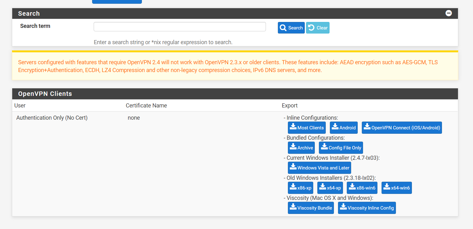

          I have changed my OpenVPN server Peer certificate authority to Internal CA. But it still shows empty vpn client configuration profiles.OpenVPN_ Client Export Utility.png
          I feel like my mind is a little jumbled on how the new users of the radius server is authenticating from OpenVPN. This is how I view it:
          We create a user within FreeRadius-->The freeradius user is integrated within the openvpn server (Based on the backend authentication we selected in creating the openvpn server) --> VPN configuration profiles are created by the vpn server.
          But I feel like there is more going on between the freeradius user and openvpn because I can not seem to have the vpnserver create the free radius user's .openvpn configuration profiles. I think it might have something to do with the Certificates?

            You are using authentication only - no user certs. There will be just one configuration for everyone in that case. There are no users for the firewall to export for other than "all"

              @Derelict That was what I was missing.. Thanks for the help.
