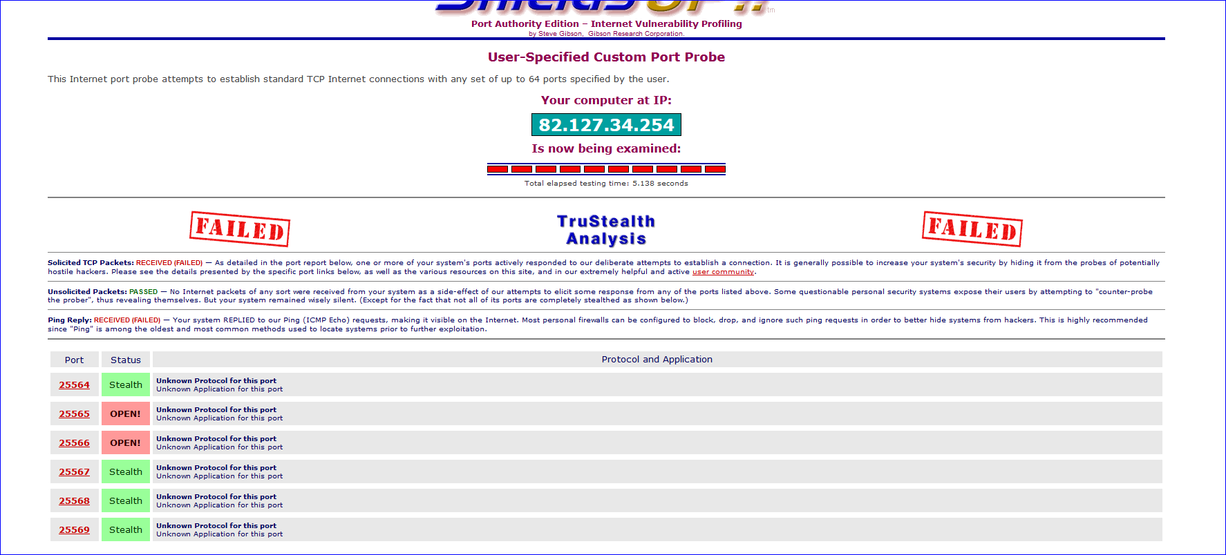

                      • GertjanG
                        Gertjan
                        @0rangeFox said in Some ports are not working:
                        25565 and 25566
                        If you have NATted port 25565 to a LAN IP - port 25565 - AND some process is actually listening on the port/IP
                        AND the LAN IP devices hasn't some firewall that blocks
                        THEN ...
                        same thing for the 25566 port.
                        Btw : I have no device that listens on my LAN these ports - so I rerouted port to port 80 (a web server - I know it works because I can visit it with my browser) on my NAS. Same thing for port 25566 that I rerouted to port 443 on the same NAS.
                        Also : I have a router in front of my pfSense, so I had to NAT on that device also for the 2 ports.
