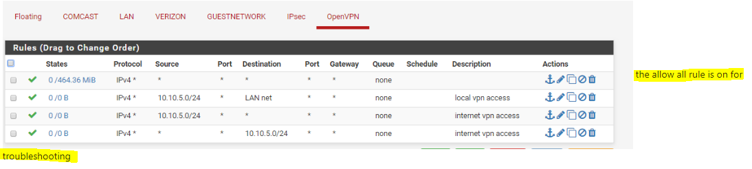

      1d5e4140-6675-4e94-96fe-7fd1e27230cc-image.png the allow all rule is on for troubleshooting
      when it stops working all clients are affected, android phones and laptops.
      I am using a Netgate XG-7100 as my pfsense box
      I will try to get a picture of the log when its not behaving but it doesn't say anything in the log out of the ordinary every time I checked. I haven't enabled a higher logging level yet as I'm afraid to fill up the device
        You do understand those 3 bottom rules are pointless with that top any any rule right.. You notice they have never been triggered once that is what the 0/0 is..
        If you have a cron that restarts openvpn service very 24 hours.. You don't have the problem?

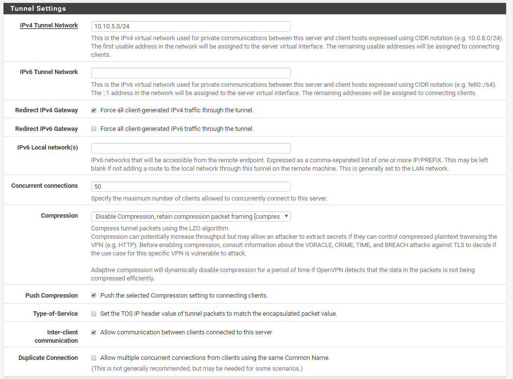

              • DerelictD Offline
                Derelict LAYER 8 Netgate
                It is almost certainly not hardware.
                Very likely a misconfiguration somewhere. Like something else inserting the tunnel network route into the routing table, a static route for the tunnel network. Something.
                The OpenVPN logs should give some indication.
