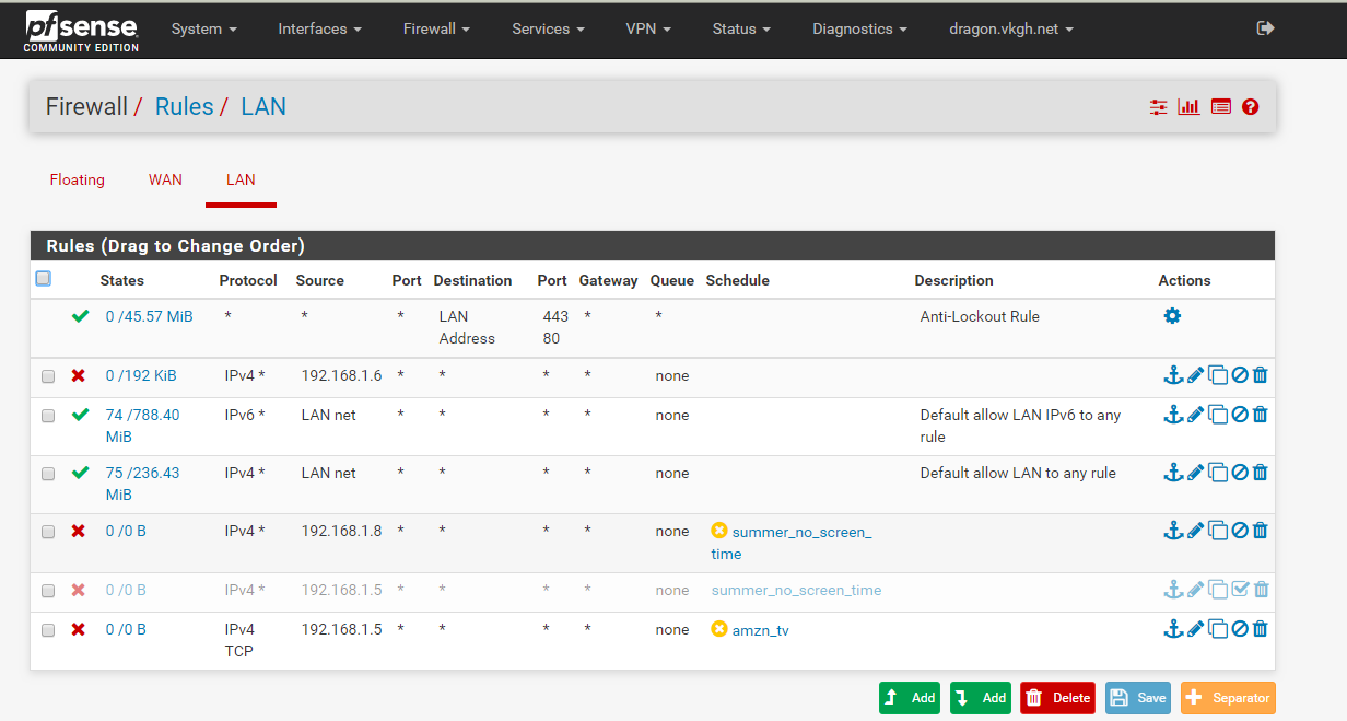

      Hi folks,
      I have a simple rule to block all traffic from an iPad host (192.168.1.6). But it is failing to block all traffic from browsers or apps like YouTube app. Can someone please help me understand why traffic is not getting blocked based on this source IP filter-
      I believe I have the order of rules correct.
      I did a packet capture and YouTube seems to be using normal port 443, so I have no idea how it is escaping this source IP-base firewall rule 😕
      Appreciate any pointers or feedback.
      Thank you.

        Maybe it is using IPv6 if it is enabled.
        If you've just added that rule while the iPad was already online, consider that you have to delete the states. Already existing connections cannot be blocked by adding a block rule.
          Yeah clearly see some hits on your block rule - but also 788MB of traffic through your ipv6 rule. With 74 active connections.

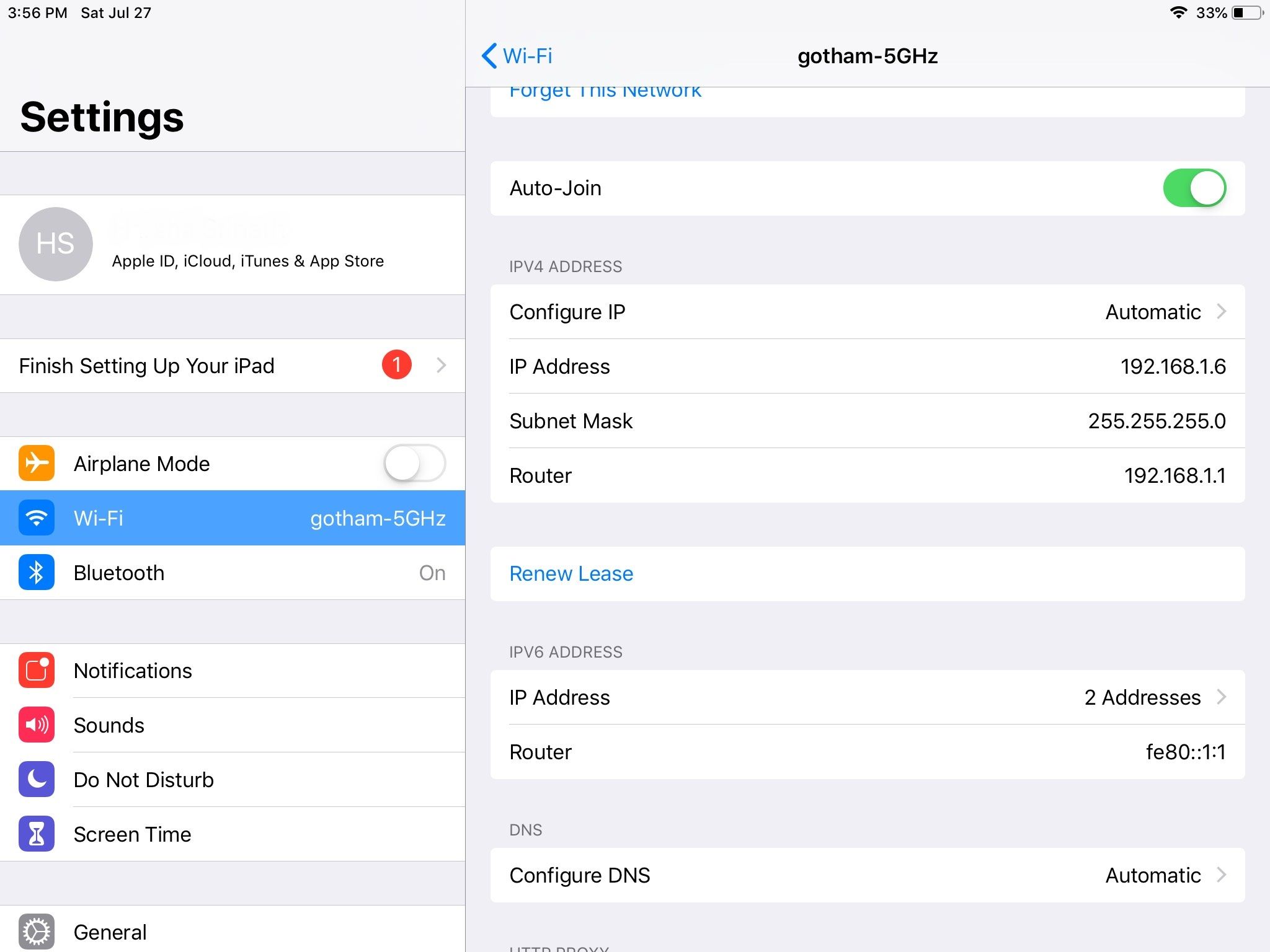

            @johnpoz I have now disabled the DHCPv6 server. Here are my iPad IP addresses -
            These IPv6 addresses cannot be used for Internet access, correct?

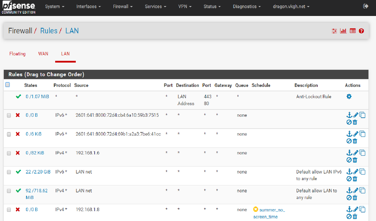

              Update- I added rules for the IPv6 addresses picked up my iPad and is now blocking all traffic! Here is the rule-
              Can someone please tell me what is the right way to configure static IPv6? Since iPad is picking up 3 IPv6 address, even I configure one static v6, will not use the other v6 addresses it is picking up automatically? Sorry for my ignorance about ipv6.

                  @johnpoz , thanks for the suggestion. I blocked IPv6 completely and with v4-only traffic, Internet acccess is now under proper control.
                  Interestingly, I had blocked DHCPv6 but iPad was still picking up some IPv6 address automatically (one of those v6 address thingys I think) and it was slipping through the IPv6 allow rule. I suppose I need to read up on IPv6 more like John said :)
