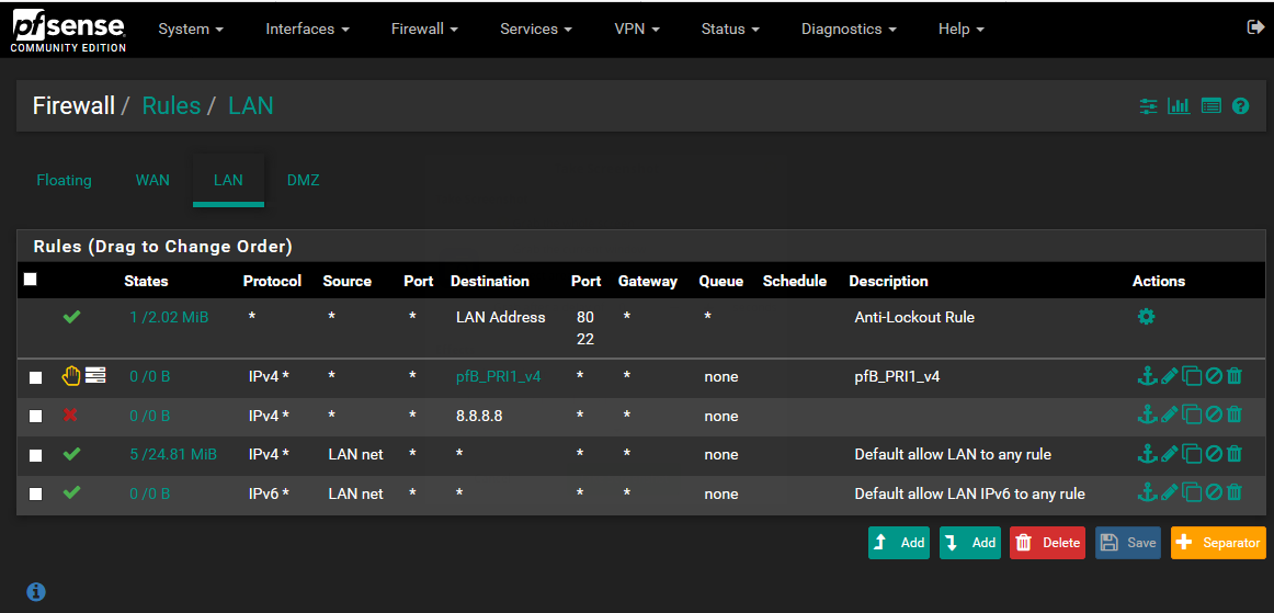

                Here, I made an example.
                I did a ping to 8.8.8 which worked. Then I added the rule below:
                Then I pinged again and it failed:
