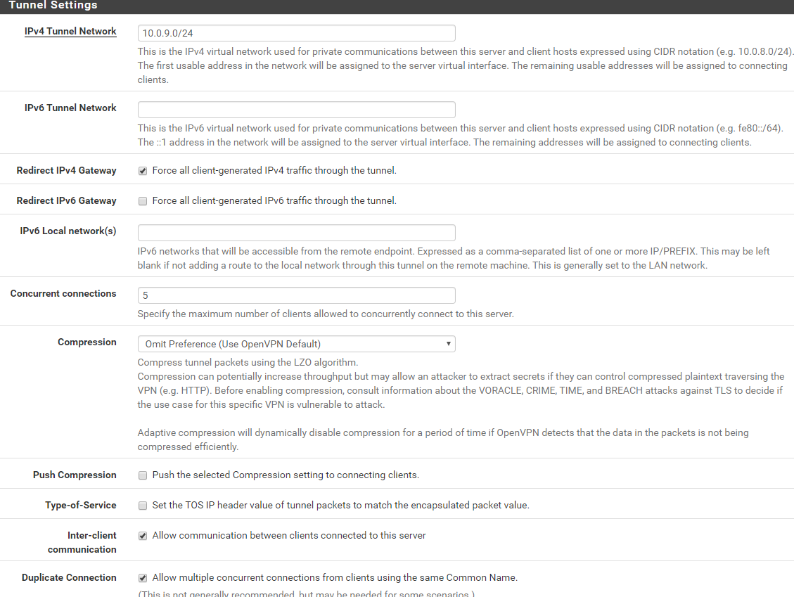

          • KOMK
            KOM
            You need to edit your OpenVPN Server instance. Go to Tunnel Settings - IPv4 Local network(s) and add your 192.168.3.0/24 network there.
            bthovenB 1 Reply Last reply Reply Quote 0

              @KOM said in Openvpn to access more than one subnets:
              Thanks. My tunnel settings already force all ipv4.
              Sorry, my .2.xx devices can access all .3.xx devices, except the Access Point (OpenWrt, 192.168.3.254) web admin page, ping from .2.xx failed. It could be any setting I need to adjust on the AP?
