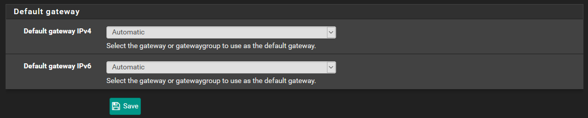

        • G Offline
          greeners
          Two gateways set; regular WAN (public IP redacted), and the Site-A tunnel endpoint. Default gateway - Automatic ?
          • KOMK Offline
            KOM
            Automatic is the default, and it's showing your WAN as default so that's good.
