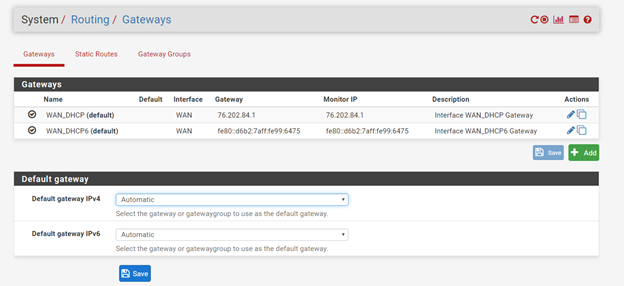

      I don't believe I have a gateway on the LAN side setup as this was a common issue when searching posts
      Below is a screen shot from System โ€“ Routing โ€“ Gateways in case I messed something up
      Below is the current status by going to Status โ€“ Gateways

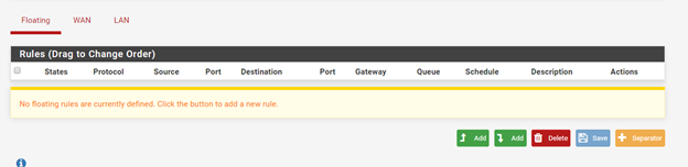

      While I mentioned the firewall rules I have set on the WAN and LAN, I thought I better show them in case my noobness screwed something up
      Floating โ€“ N/A
      WAN
      LAN

                      @johnpoz said in Unable to Browse Internet:
                      under 1 ms to your isp device.. That is pretty freaking good..
                      Suspiciously so. It's monitoring something very close which will not show packet loss upstream of that.
                      You might want to change the monitoring target to some other public IP that responds to ping. 8.8.8.8 is a common choice.

                        Now one of the gateways shows "pending" - not sure if this is indicative of an issue or not.
                          You can set a custom target by editing the gateway in System > Routing.
                          The v6 gateway was monitoring the link local address so that was not showing anything upstream. It should still be doing so though unless you disabled IPv6 somewhere.
