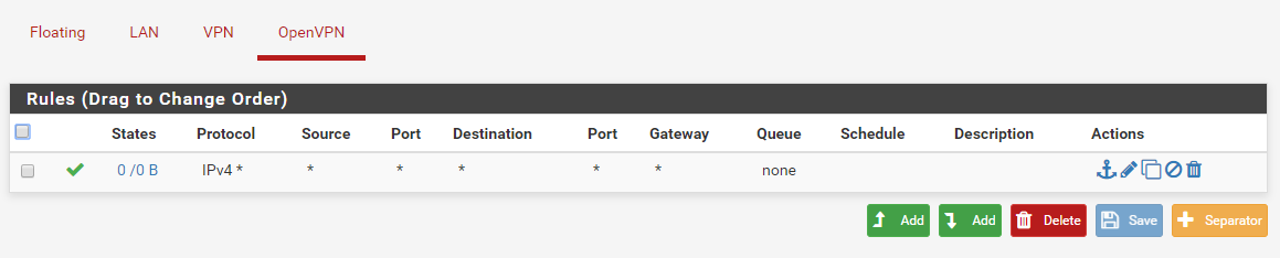

              Below is Site 2 Firewall Rules

                I assume your LAN rules are all default? There is no traffic that has hit that rule you have the screenshot of above.. Look at your firewall logs. Do you see any blocked traffic when you try to ping or otherwise?
                    Your assumption is correct
