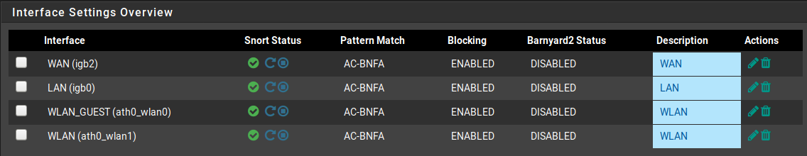

      Hello, I'm very new of pfsense, and I'm experiencing a problem with snort configuration: I have a uplink modem (10.0.10.254/24) going to pfsense WAN interface (10.0.10.250/24) with LAN (10.0.40.1/24) and WLAN interface (10.0.60.1/24). Configured snort 3.2 (on WAN, LAN, WLAN) with register rule set, ET, GPLv2 and OpenAppID and experienced a blocked connection at sposts on LAN and WLAN. I suspect there is a rule that put on block list the pfsense WAN interface. Is it safe (or it's possible) to put it on whitelist? I'm strunggling with this from days, please help me solve this. Thanks
      • NollipfSenseN Offline
        NollipfSense
        Something about your setup has misconfiguration especially if you're blocking LAN/Wlan. It helps us to better diagnose and guide you when you also post screen shots of your Snort config.

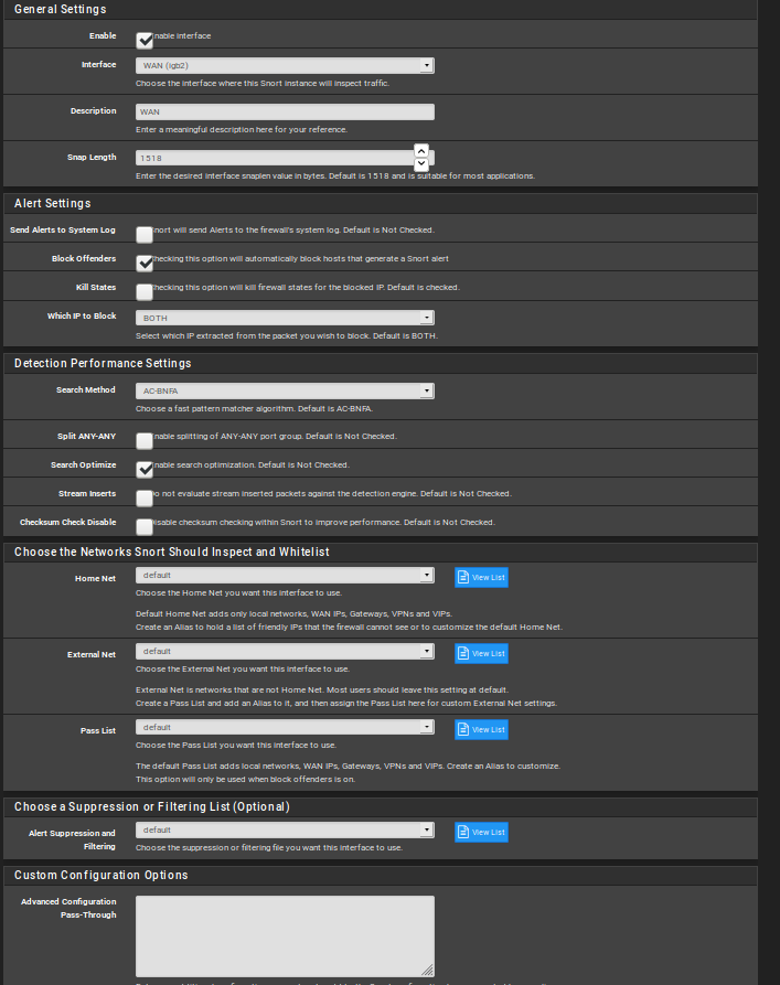

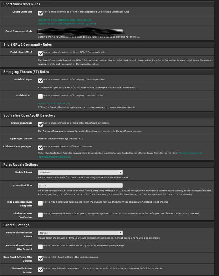

          This is my configuration:
          here have selected all categories
          Thanks for your help

              Also have these settings on all interfaces:

                You state you are a new pfSense user. Have you ever used an IDS/IPS package before? If not, you should never, ever enable blocking out of the gate. You should first enable the IDS in non-blocking mode and then run that way with your configured rules for at least a week, and preferrably longer, if you are very new to an IDS. Examine the alerts you receive and then research each one to determine if it is a false positive in your network environment. If you determine a given rule false positives in your setup, then disable that rule or suppress it.
                The ALERTS tab will show you every alert received for a configured Snort interface. There is a drop-down selector on that tab to let you choose which interface to display the alerts for.
                Installing the IDS/IPS package and then immediately enabling blocking mode when you are new to administering an IDS/IPS results in exactly what is happening to you -- namely false positives and nuisance blocks.
                Turn off blocking mode, go to the BLOCKED tab and clear all existing blocks, then run that way for two weeks and examine the received alerts at least once per day and determine which rules you do not need.
                Configuring and adminstering an IDS/IPS requires a specific skill set. And even then a willingness on the part of the admin to spend a lot of time researching things on Google and other resources. You can't just install the Snort package, take a default setup, and get a happy result. An IDS/IPS package such as Snort or Suricata is way more complicated than installing say an anti-virus client and enabling the download of virus signatures.
