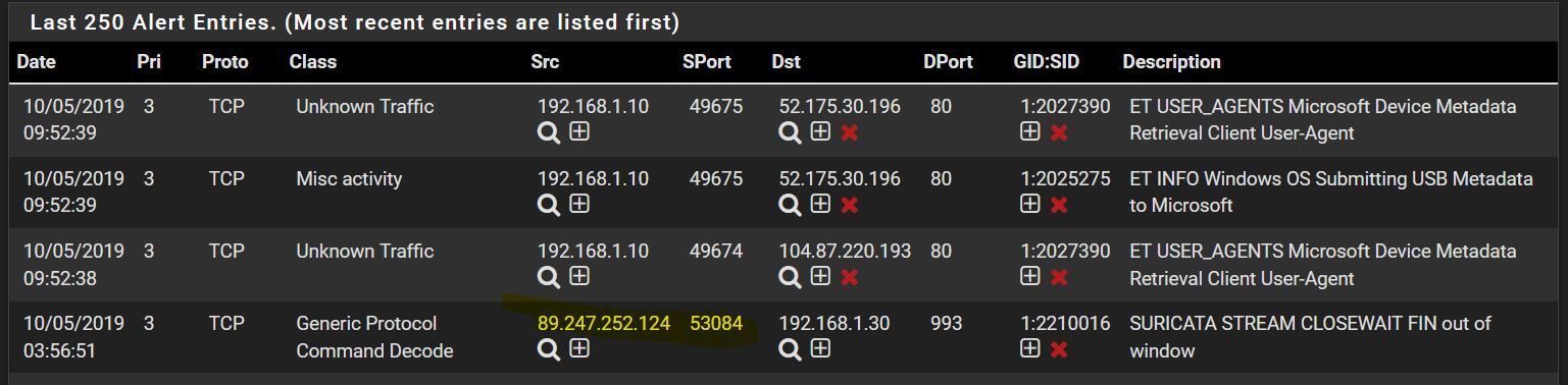

Also it seems not blocking everything again.
@Bob-Dig said in Suricata v4.1.5 Release Notes (now available for pfSense-2.4.4 RELEASE):
What is the "Remove Blocked Hosts Interval" option set for on the GLOBAL SETTINGS page? There appears to be a 6 hour time difference in the alert times shown in your screen capture (03:56 for the highlighted alert versus 09:52 for the next alert up). Perhaps the cron task has already removed the blocked host? The task will remove blocks for hosts that have not seen additional traffic for the time period specified by the setting. The suggested setting in the help text for that control is 1 hour.
@bmeeks You could be right. I changed it recently and now it is only one hour. I will change that again to 24 hours. Thanks and sorry for the "false alarm".

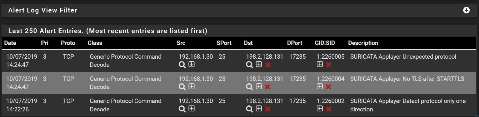

Hmmm, but how is this even possible?
There was a two minute delay between the alerts.
How is what possible?
If you asking about the same IP addresses showing on the alerts tab that is normal. You have to understand where the IDS/IPS is located in the packet chain versus where the blocking is happening.
Suricata runs (in Legacy Mode) directly on the interface driver using libpcap to get a copy of every packet that hits the interface. This all happens out in front of the pfSense firewall. Blocking is done by the firewall, not Suricata. When Suricata sees an "alert", it sends that IP address downstream to the firewall and says "from now on, block this". The IP address is added to the snort2c
pftable and then, so long as the IP remains in that table, the firewall will block traffic from that IP address from reaching the kernel network stack. However, out there on the physical NIC interface Suricata will continue to see packets arriving from that IP and it will still log the alerts. But the IP is already blocked as evidenced by the red X icon.So your screen capture above is perfectly normal. Go read this Sticky Thread to learn a bit more about how Legacy and Inline IPS mode actually operate. That should help you understand why you see what you see on the ALERTS tab.
@bmeeks Suricata runs here on the LAN Interface so I thought it would be blocked first. Thanks for your clarification.
Look at the SRC. I suspect that is one of your LAN hosts, so that traffic hits Suricata on the LAN interface before the firewall sees the traffic. In this case your LAN host was attempting to communicate with the external host at 192.2.128.131. The external host is going to be blocked by the firewall, but Suricata is seeing the communication attempt before the firewall does because this is traffic inbound to the LAN interface from your LAN host destined for that remote IP on the Internet. However, the traffic is going to be blocked by the firewall. You can tell by noting the red X beside the destination IP.
The traffic flow when using an IDS/IPS is always like this for inbound traffic:
Physical NIC --> IDS/IPS --> firewall (rules)
This is the same for any interface (LAN, WAN, DMZ, etc.).
For outbound traffic (i.e., traffic leaving your firewall the flow chain looks like this:
firewall (rules) --> IDS/IPS --> Physical NIC
