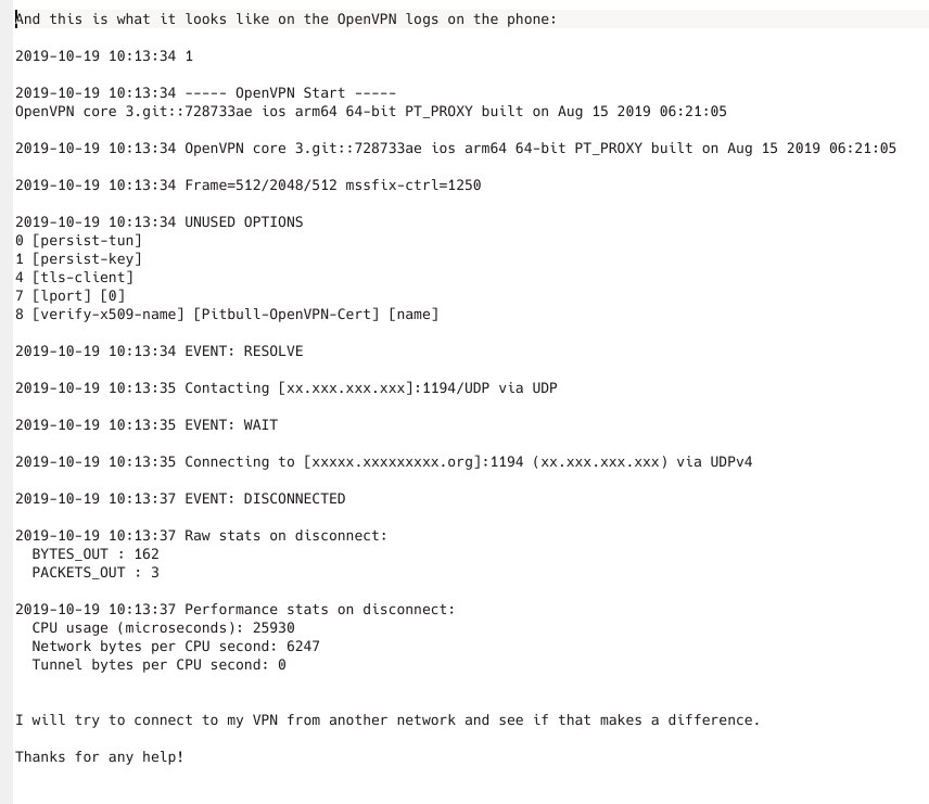

          From /var/log/openvpn.log on PFSense server when I unsuccessfully connect from iPhone from WAN side. I would get the same result if I connected from my laptop connected to the phones hotspot:
          Oct 19 10:05:26 pitbull openvpn[55881]: WARNING: No server certificate verification method has been enabled. See http://openvpn.net/howto.html#mitm for more info.
          Oct 19 10:05:26 pitbull openvpn[55881]: NOTE: the current --script-security setting may allow this configuration to call user-defined scripts
          Oct 19 10:05:26 pitbull openvpn[55881]: TCP/UDP: Preserving recently used remote address: [AF_INET]xx.xxx.xxx.xxx:1194
          Oct 19 10:05:26 pitbull openvpn[55881]: UDPv4 link local (bound): [AF_INET]xx.xxx.xxx.xxx:0
          Oct 19 10:05:26 pitbull openvpn[55881]: UDPv4 link remote: [AF_INET]xx.xxx.xxx.xxx:1194
          Oct 19 10:05:26 pitbull openvpn[487]: Authenticate/Decrypt packet error: packet HMAC authentication failed
          Oct 19 10:05:26 pitbull openvpn[487]: TLS Error: incoming packet authentication failed from [AF_INET]xx.xxx.xxx.xxx:37900
          Oct 19 10:05:28 pitbull openvpn[487]: Authenticate/Decrypt packet error: packet HMAC authentication failed
          Oct 19 10:05:28 pitbull openvpn[487]: TLS Error: incoming packet authentication failed from [AF_INET]xx.xxx.xxx.xxx:37900
          Oct 19 10:05:33 pitbull openvpn[487]: Authenticate/Decrypt packet error: packet HMAC authentication failed
          Oct 19 10:05:33 pitbull openvpn[487]: TLS Error: incoming packet authentication failed from [AF_INET]xx.xxx.xxx.xxx:37900
          Oct 19 10:05:41 pitbull openvpn[487]: Authenticate/Decrypt packet error: packet HMAC authentication failed
          Oct 19 10:05:41 pitbull openvpn[487]: TLS Error: incoming packet authentication failed from [AF_INET]xx.xxx.xxx.xxx:37900
          Oct 19 10:05:57 pitbull openvpn[487]: Authenticate/Decrypt packet error: packet HMAC authentication failed
          Oct 19 10:05:57 pitbull openvpn[487]: TLS Error: incoming packet authentication failed from [AF_INET]xx.xxx.xxx.xxx:37900
          Oct 19 10:06:26 pitbull openvpn[55881]: [UNDEF] Inactivity timeout (--ping-restart), restarting
          Oct 19 10:06:26 pitbull openvpn[55881]: SIGUSR1[soft,ping-restart] received, process restarting
