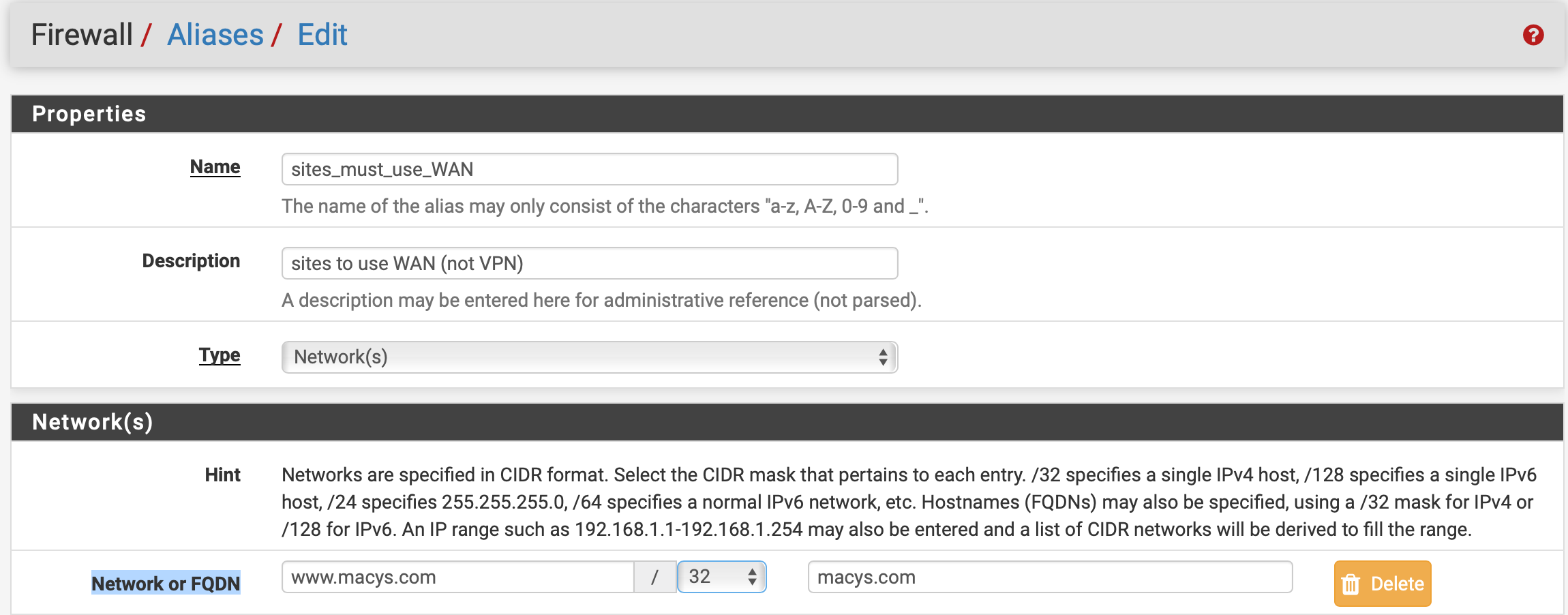

      I have a problem with accessing macys.com form an interface that route all traffic through vpn, so I decided to create an alias for websites that doesn't work through vpn and redirect them through WAN.
      For that I created an Alias:

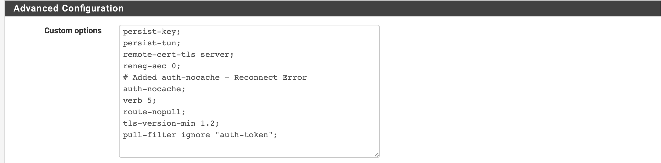

          Also I have next lines added in the Advanced Configuration/Custom options:
          Screen Shot 2019-10-20 at 7.59.40 PM.png.
          I have directly set the WAN gateway in the Advanced options of the firewall rule for sites_must_use_WAN alias
