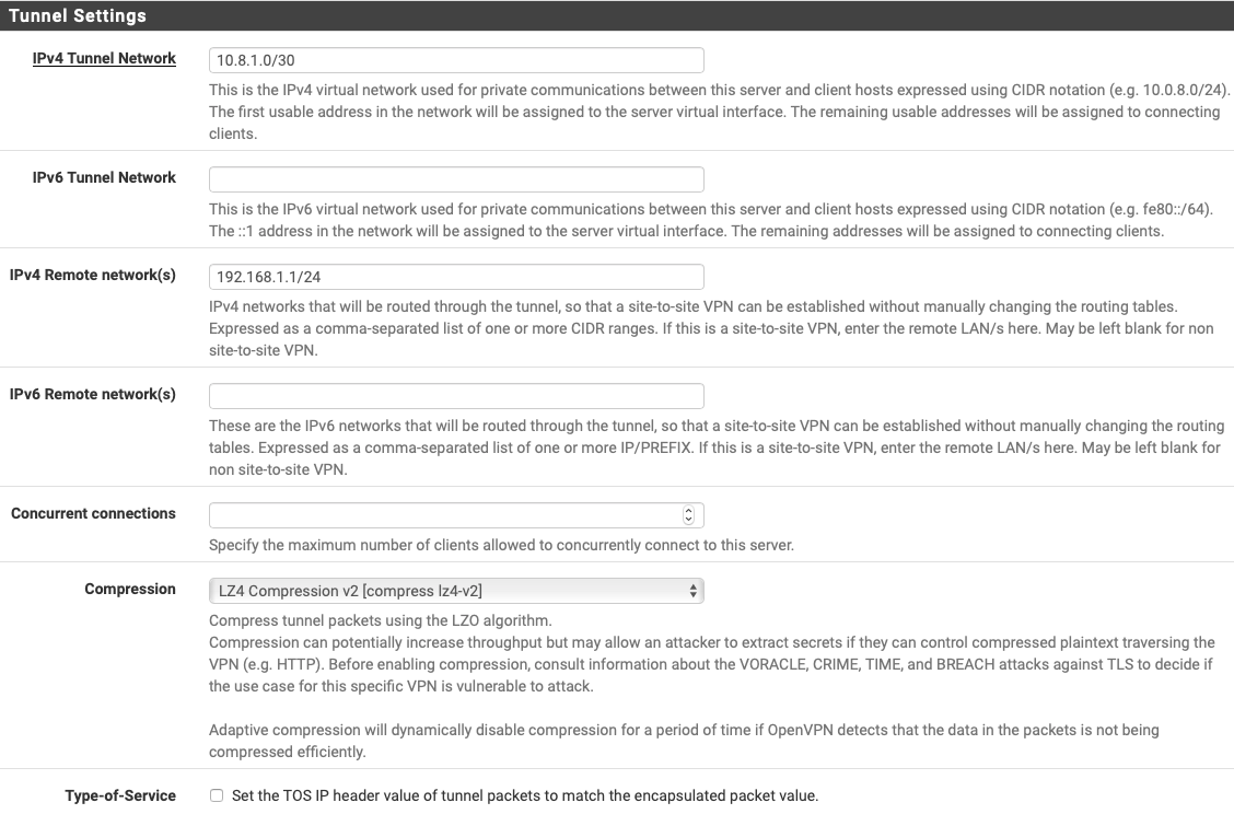

      Hi guys,
      I have an Open VPN P2P (Shared key) up and running.
      The problem is that the connexion is very slow, making it almost unusable.
      Each office has a 1000 mbps (up), 1000 mbps (down), optic fiber internet connection.
      On one side there is a SG-3100 (headquarters)
      On the side there is a SG-1100 (remote office)
      We're using the VPN mostly to connect to SMB shares.
      With 1000/1000 connections on both side, I was expecting to have a speed similar to what we were experiencing locally.
      The reality is that every day, we experience such slow speed that it is impossible to work, so I really need to fix this and improve the speed. Any help would be greatly appreciated.
      I posted my configuration below.
      My questions :
      • What parameters can I tweak to make the whole experience faster?
        • Encryption Algorithm : right now set to AES-128-CBC
        • NCP Algorithms : right now set to AES-128-CGm
        • Auth digest algorithm : right now set to SHA256
        • Hardware Crypto : right now enabled
        • Compression : right now set to LZ4 v2
        • UDP fast I/O : right now enabled
        • Anything else??
      • Is there any way to prioritize the VPN (ex: QoS)? I tried running the trafic shaper wizard but I couldn't find anything regarding OpenVPN
      • Any other tips would be greatly appreciated

        Something is definitely wrong. I have pfSense virtualized under ESXi at work, and an SG-1100 at home. Work link is 100/100, home is 150/15. OpenVPN is smooth as butter. The only difference in my settings as compared to your is Enable NCP checked, and the Compression which I have set to Adaptive LZO Compression [Legacy style, comp-lzo-adaptive].

                Do not select any Hardware Crypto on server and client side.
                Add
                mssfix 1400
                to the Custom options field and try again.
                AES-128-CBC/SHA256/AES-128-GCM is fine, it will use AES-128-CBC/SHA256 in your case because you did not select NCP.
                Fast I/O is fine.
                You can also play with Send/Receive Buffer value up to 512K, anything above that makes no difference in my experience.
