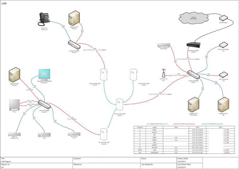

@NogBadTheBad why do you have your nas in 2 different vlans? Also why not leverage some of the other ports on your 4860 for vlan uplinks... You have all your vlans sharing the same physical link, so your intervlan traffic is going to be bottlenecked by the limit of that physical port. Why not create a lagg and put all the vlans on the lagg, or just split the vlans across the different physical ports manually?
The 2 ports in the nas is down to the Naim Muso player that’s controllable via DNLA from my iPhone / iPad that sit on the USER VLAN and the Apple-TV, TVs that sit on the IOT VLAN, it’s not ideal I know but the firewall on the NAS only allows SMB traffic.
Also the Macs backup to the nas and Timecapsule.
The non LAG on the router is due to all the ports on switch-1 being used, nearly all the traffic doesn’t go cross VLAN anyhow.
Time for a switch upgrade then ;) seems..
If your not doing any sort of real intervlan traffic not big issues no.. Just seems like the 4860 with all its interfaces a bit oversized..
When the Timecapsule dies I’ll LAG the router :)
