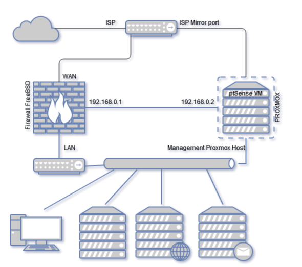

      May be will be interest my result of :
      pfsense sync pf table snort2c to another firewall
      Loop batch with 2 seconds delay is currently analyzing the pfSense side snort2c table and transmitting commands when changes are detected to the FreeBSD server using the snmp protocol by the snmpinform command.
      https://lexxai.blogspot.com/2019/11/pfsense-pf-snort2c-firewall.html
      alt text
      But may be can be it easy method with barnyard2 instead of in loop scan pf table snort2c for changes ?

          I may not have fully described the diagrams.
          Real gateway server only one (192.168.0.1) only this server can block ip for local LAN,
          pfSense on VM (192.168.0.2) only used as external IDS server and not have access to local LAN and used only for listening WAN (ISP Mirror).
          Server (192.168.0.1) not have installed SNORT app.
          We have what we have. Everything that happens - for the better.

            @lexxai said in pfsense sync pf table snort2c to another firewall by scan loop, but what if use barnyard2 ?:
            Why would server 192.168.0.1 not have Snort installed? If you want that box to protect the LAN, that's really where Snort should be. It makes no sense to me to run Snort on the 192.168.0.2 box, but not let it actually block anything locally and instead copy its snort2c block table over to FreeBSD at 192.168.0.1. I assume you have created that table in pf on the FreeBSD box and created the matching firewall rules to use that table.
            You do realize that there will be delays in getting the blocks copied over and put in place on the 192.168.0.1 firewall. Also, what are you doing about the states that get established on the 192.168.0.1 firewall while it is waiting on your update script to run and copy the contents of the 192.168.0.2 snort2c table over to the 192.168.0.1 firewall? The very first packet to hit on the 0.1 firewall will create a state entry, and thus any further traffic from those IP addresses will be allowed no matter what you put in the snort2c table. You will need to clear out the existing states for every IP in each block you copy over from the 0.2 firewall.
            The default Snort configuration is to use libpcap to analyze copies of packets as they traverse the interface. The original packet will continue on to the FreeBSD (or pfSense) network stack while Snort works on the copy. That original packet will create a state table entry on the 192.168.0.1 box, and that state table entry will then let all other traffic from that session pass without ever consulting another firewall rule (unless you kill that particular state).
            As I said to start with, this is a large amount of complexity with several breaking points for no gain in security. Just run Snort on the 192.168.0.1 firewall if you want the protection afforded by Snort. You can run the Snort binary package just fine from FreeBSD ports over on that FreeBSD server. No need for all the complexity.
