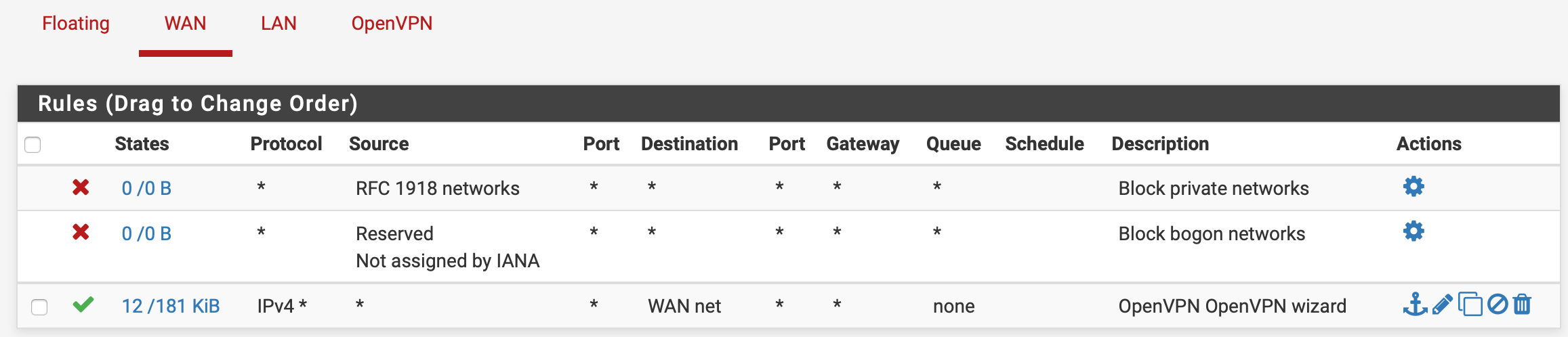

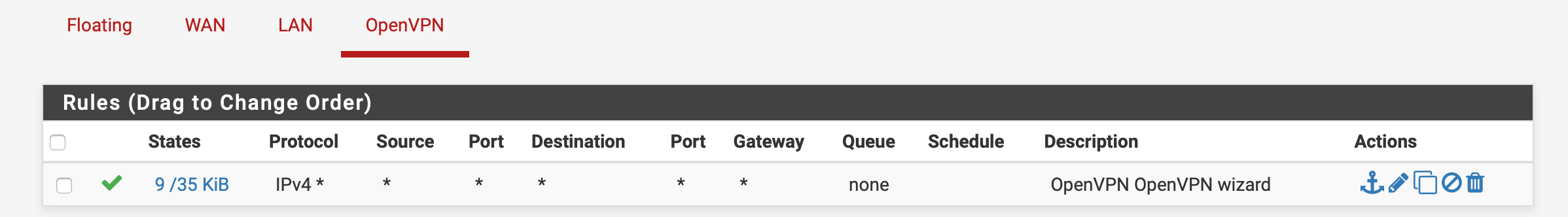

      I'm no network guru, so I used the VPN setup wizard to help things along. It setup two rules in the firewall:
      On the WAN:

      On the OpenVPN group:

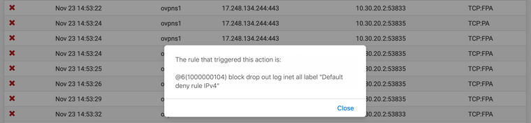

      On all accounts it seems to me like the rules allow any to any, on any protocol. So I'm not sure why things aren't quite working. The firewall dynamic view shows lots of denied packets (10.30.20.2 is a client):
      Except there is a rule explicitly allowing any IPv4, so I'm not sure why these packets are being denied.

        And all of those blocked would seem to be out of state, see the A in the flags.. And even more than that all but one of them have the FIN flag, so they are FIN,ACK - meaning close this connection.
        And they seem to be all to the same IP and port, so duplicate packets most likely anyway..

          I wasn't aware those were flags. The column is labeled only as "Protocol". What can you infer from this?
          The VPN has only a single client at the moment, which is me on another computer testing things out. On that client I am trying to ping LAN hosts or connect to a LAN share. The connections on the client are timing out, so it continues to try indefinitely.

            Without full understanding of your paths, hard to say exactly why your seeing them.
            But the little i right on the firewall log shows you what they are
            You can quite often see FA due to retrans when the client/server doesn't see a response for whatever reason on the closure of the session. And the state has been closed by the firewall.
            When trying use a stateful firewall, its very helpful to understand how tcp initiates a session and how it closes a session ;)
            Unless the block is S (syn) - its a given that the reason for the block is no state in the firewall for that traffic.

              I'm also not sure about that firewall rule on your WAN tab. The wizard should give you something similar to this:

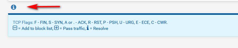

                https://docs.netgate.com/pfsense/en/latest/firewall/tcp-flag-definitions.html
                  I think that rule is certainly better, as the other I showed allowed much more through the firewall. I edited the rule as you show. I am able to still connect, so I'll leave the restrictive rule. Thanks for that.
