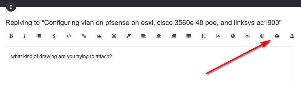

                              I tried and it didn't let me, and when I clicked the add image icon it gave me this way to do it.
                              I did my desktop that way because I it isn't in the same room as the servers and switches, so I had a small switch and have that by the desktop. The 2 NICs make it where I can google things as I break them without spending more time switching ports than working on it.
                              • johnpozJ Online
                                What kind of drawing are you trying to attach? is it not a picture format file?
