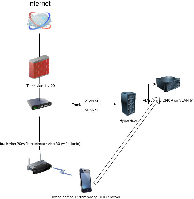

          AsM0DeUz01
          I don't see what other way ... here is a diagram:
          All the devices connected to the wifi get IP from the VLAN 51 where that standalone DHCP is running.
          In the pfsense logs I get this kind of messages:
          DHCPREQUEST for 192.168.51.120 (192.168.30.1) from aa:aa:aa:aa:aa:aa via igb1: wrong network.
