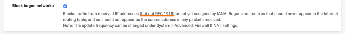

                                  Then the above description by pfSense is misleading...

                                  • johnpozJ Online
                                    See my edit.. Pfsense pulls it out of bogon, because they use their own other rfc1918 block table..
                                    Here is the thing if your setting bogon on your lan your doing it WRONG!!! There is zero reason to set that, and clearly you have no clue to what it actually is or you wouldn't be setting it..
                                    • T Offline
                                      techtester-m @johnpoz
                                      @johnpoz Well...the only scenario I could think of is a virus or malicious software sitting on the lan and using bogon addresses LOL....Ok, I removed that rule. It should only be set on the WAN
