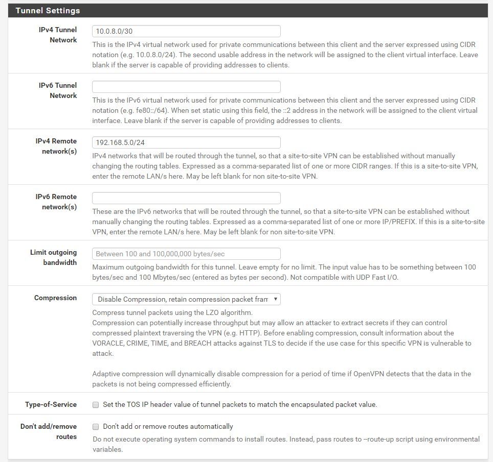

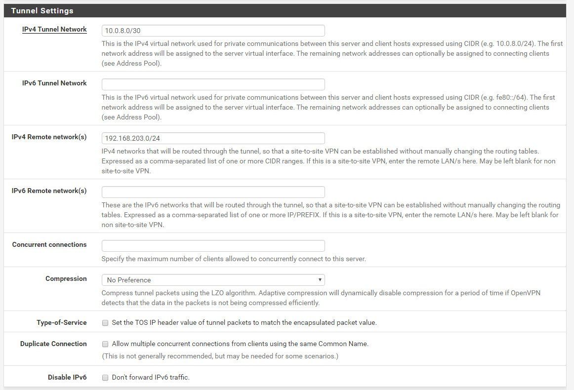

            this is screenshot for the client (2.4.4):
            this is for server side (2.3.4):

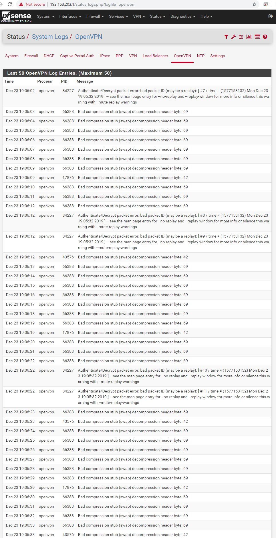

            this is log for client side:
            this is for server side:

              try to change "Compression" try to set it on, both device, instead of "No Preference" or try to set it off on both device
              idk what you have available on 2.3.4, anyway they must match
                mike8888
                It works!! Thanks for yours eagle eye Kiokoman!!
                I missed the compression, I just missed it completely
                It's very different options in 2.4.4 compared to 2.3.x or 2.2.x
                I take it for granted that it would not change
                I tried diff compression options, and the one that works best for me is:
                at 2.4.4 use LZO Compression [Legacy style, comp-lzo yes]
                at 2.3.4 use Enable without Adaptive Compression
