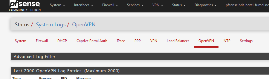

      While trying to setup remote access to the firewall via OpenVPN i see the below error on the GUI(see attached screenshot).
      What would be the issue?

          Gertjan @Druplex
          @Druplex said in OpenVPN unable to contact daemon pfsense 2.4.4_3:
          The OpenVPN setup, the file with parameters that makes de service == daemon run correctly, contains errors. In this case, it's the place where you setup the OpenVPN settings.
          So the daemon (== service) starts, and fails to work correctly, so it stops.
          The GUI, let's say 'pfSense', can't contact the daemon, so it tells you what happens.
          Btw : to have the OpenVPN server logs telling you what's right and what's wrong, think about putting the "Verbosity level" to 3 or 4.
          Then go here :
