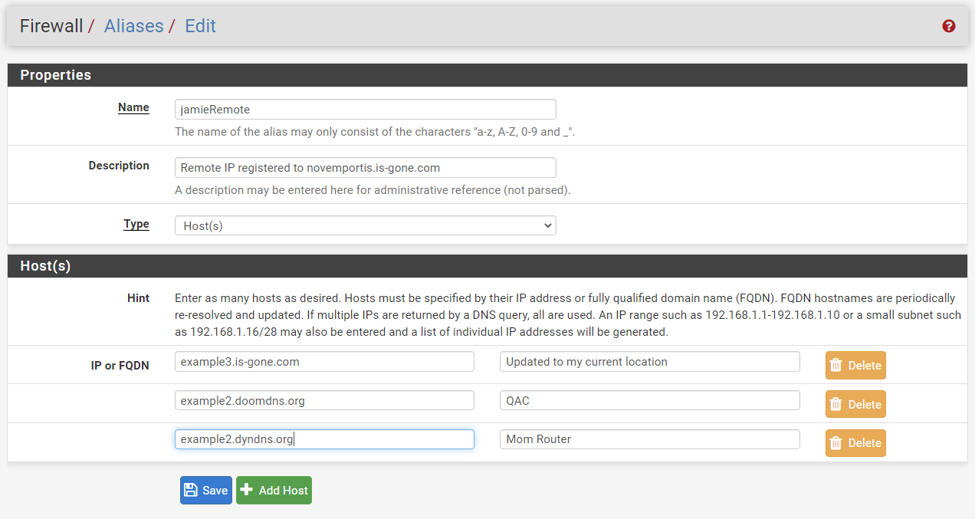

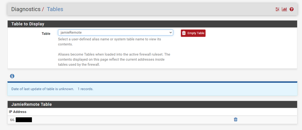

      I have an Alias setup using the IP category, and using the host(s) type. Within, I have 3 rows with FQDN's like example1.dyndns.org, example2.dyndns.org, example3.dyndns.org. I've gone into diagnostics and done a DNS lookup on each, and they all respond. My Issue is that I expect Diagnostics-Tables should show my table containing 3 IPs, but as far as I can see it only contains 1 any time I look.
      I'm running into an issue that I know I can fix by adding more firewall rules, but I'd like to avoid.
      My problem is that I have a rule linked to this alias to all a VPN connection and I'll agree what I"m doing is stupid, but it should work. So example1 is a house I sometimes work from, example2 is my work, and example3 follows me (my laptop updates dyn wherever I am). Where I"m running into an issue, it lets me log in to the VPN, but then my dyn updater changes example3 to my pfsense location. This works fine until I disconnect and if I want to reconnect it won't work until I wait for my dyn to update again. The problem I"m seeing is that the table holds only the pfsense IP, until the dns resolver kicks in again. But if the table held example2 it would work.

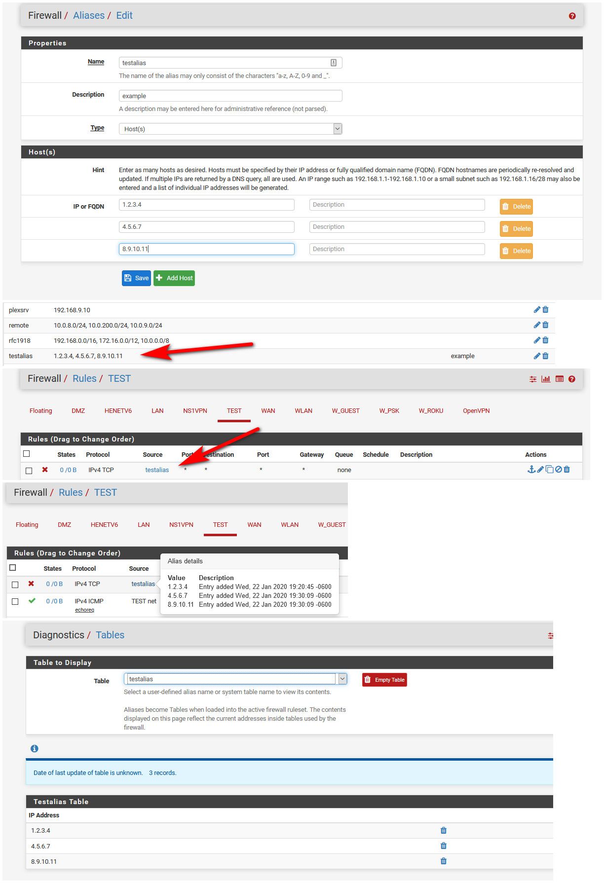

        Did you put the alias in a rule?
        here
          james416
          As far as I can see mine is the same. My 3 host items are the FQDN's instead of the IPs in yours. The alias is the source in more than 1 rule, when I mouse over the alias in the source, it shows the 3 FQDNs. But the Diagnostics has only ever shown 1 IP address listed and not the 3 I'm expecting. Though technically 2 of my FQDN's may be the same IP, so I'd be fine seeing 2, but I've been checking periodically over the last week and only ever see 1.
          I saw someone complaining they had issues with the same 2 FQDN's in existing in different aliases so I've tried removing that one, didn't help. I've replaced one of the FQDN items with the other alias (suggested in another post to avoid looking it up twice).
          And as far as I can tell, it's using the top listed FQDN, which is the one that follows me, so when I look at the table the single IP it shows does change. I'll try to figure out how to post images but the only differences are what i mentioned, using FQDN instead of IPs, and Table only shows 1 item.

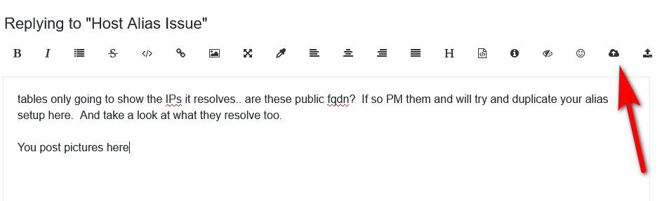

            You post pictures here

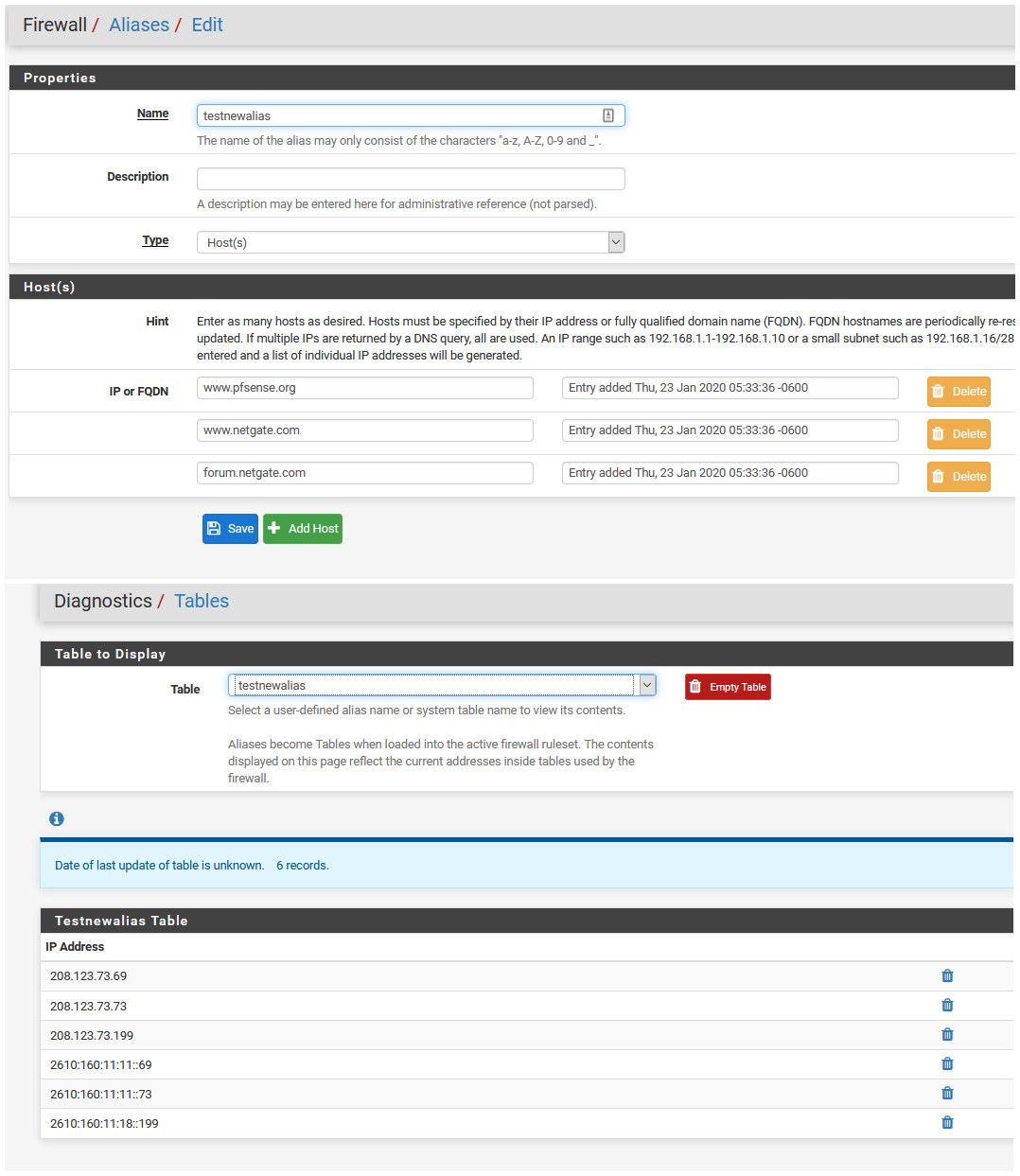

                Here I put in
                www.pfsense.org
                forum.netgate.com
                www.netgate.com
                All the IPs they resolve too, even the AAAA are listed in the table.
