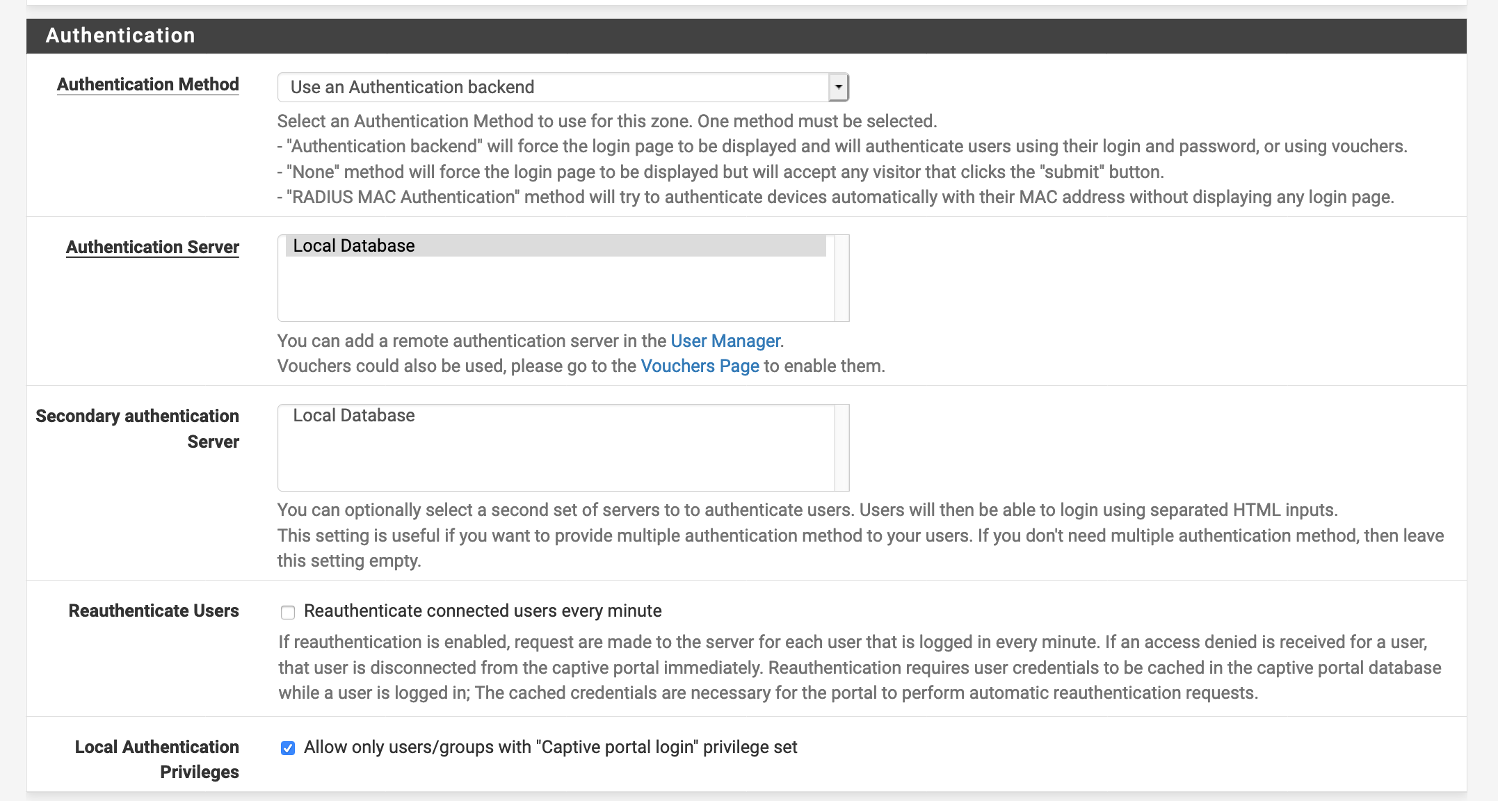

        There are no problems with my internet connection. What I meant was that when attempting to connect to the guest network where the CP should be (but is not showing up), the device cannot connect to the internet (presumably because it has not authenticated itself yet, which is because pfSense doesn't seem to allow me to use voucher authentication!)
        • P Offline
          pfguy2018
          The only issue seems to be that the option for using vouchers as the authentication method is not showing up where expected (on the configuration tab). That is what I am trying to solve.

            • on the GUI, Vouchers is not supposed to appear on the list in the configuration page.

                I spoke too soon I think. I created a firewall rule to pass port 80 traffic to the gateway, but the CP still times out. I am stumped.
                Also, when I try to save the CP configuration, I cannot save unless I select an authentication method. If vouchers is not one of the choices listed, what am I supposed to click on prior to saving?
