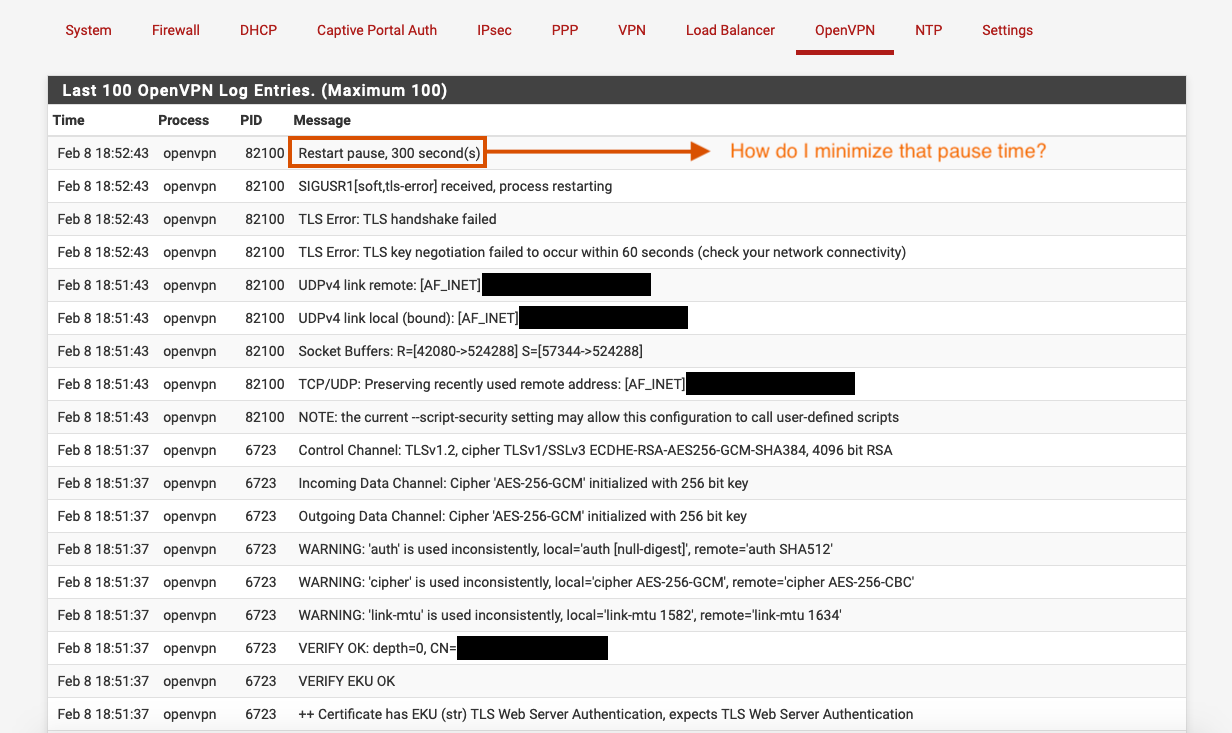

      Few questions:
      1. What is going on in the logs seen in the below screenshot and what should I do about it?
      2. How do I decrease the "pause time" (first line in the log) for reconnecting to the VPN?
      3. Does the problem come from my end or the VPN provider's?
      Thank you,

        Please see, --connect-retry n [max] and --connect-retry-max n in manual 2.4:
        https://community.openvpn.net/openvpn/wiki/Openvpn24ManPage

          @Pippin Thank you, I set up a maximum, but could you please answer the other questions?
          Why is this happening? who's fault is it? etc...

                @Grimeton The remote server never changes its own IP, but can dynamically change the IP of its clients - in this case my pfSense router. If I understood you correctly and this is what you meant than how do I enable that handling of IP changes?
                EDIT: Just chatted with NordVPN's support team. They say that the problem is not on my end (pfSense router) and it's probably because UDP problems. They assume my ISP blocks UDP or something. So I asked them why does it happen only few times a day and they answered "because that's the way it is" ahhh Go figure....Sometimes they really useful and sometimes just giving me a headache. Anyway...if it's really not on my end than I don't care and I'll live with it because TCP if SLOW AF!!!
                If anyone has a different idea than NordVPN's support team, by all means go ahead.
                Thank you,

                        @Grimeton Ohhh lol...of course not! I meant the virtual IP of the VPN client, for inner VPN purposes - 10.x.x.x etc.
                        EDIT: So...nobody knows why the disconnections?

                            @Grimeton So...nobody knows why the disconnections?

                                techtester-m @Grimeton
                                @Grimeton said in Wierd OpenVPN client behaviour causing disconnections:
                                Networking issues, followed by an ICMP package containing proto or port unreachable.
                                ICMP package coming from me out to the server or vice versa?
                                Networking issues causing OpenVPNs internal timer to timeout and disconnect/reconnect.
                                What should I do in such case?
                                EDIT: I've noticed that it usually happens when one of the VPNs in the VPN group (of 2) is going down (for maintenance or whatever) and because both/all of them are marked as Tier1 it may cause such reconnection attempts...on the other hand that's why we have VPN groups and Tier priority LOL
