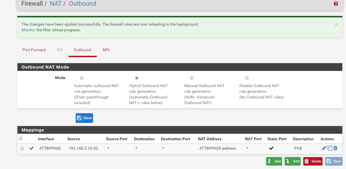

                      Static source port outbound is required for a lot of games (which is absurd IMO but....) but some also require UPnP. You may find you still need that.
                      Of course by having the PS4 in a different subnet you are limiting exposure to that only.
