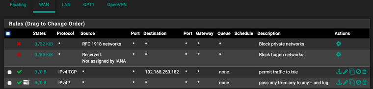

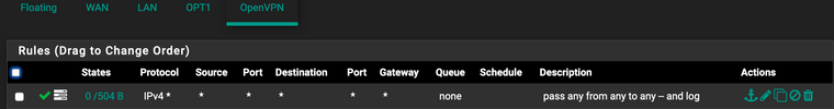

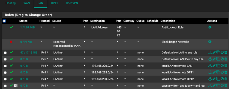

          pfSense's firewall rules are these:
          I don't know about a Windows firewall. All client machines are Macs (which is essentially BSD), the servers run FreeBSD.
          • B Offline
            birnbacs
            That's the B router (home). The A router has corresponding FW rules.
