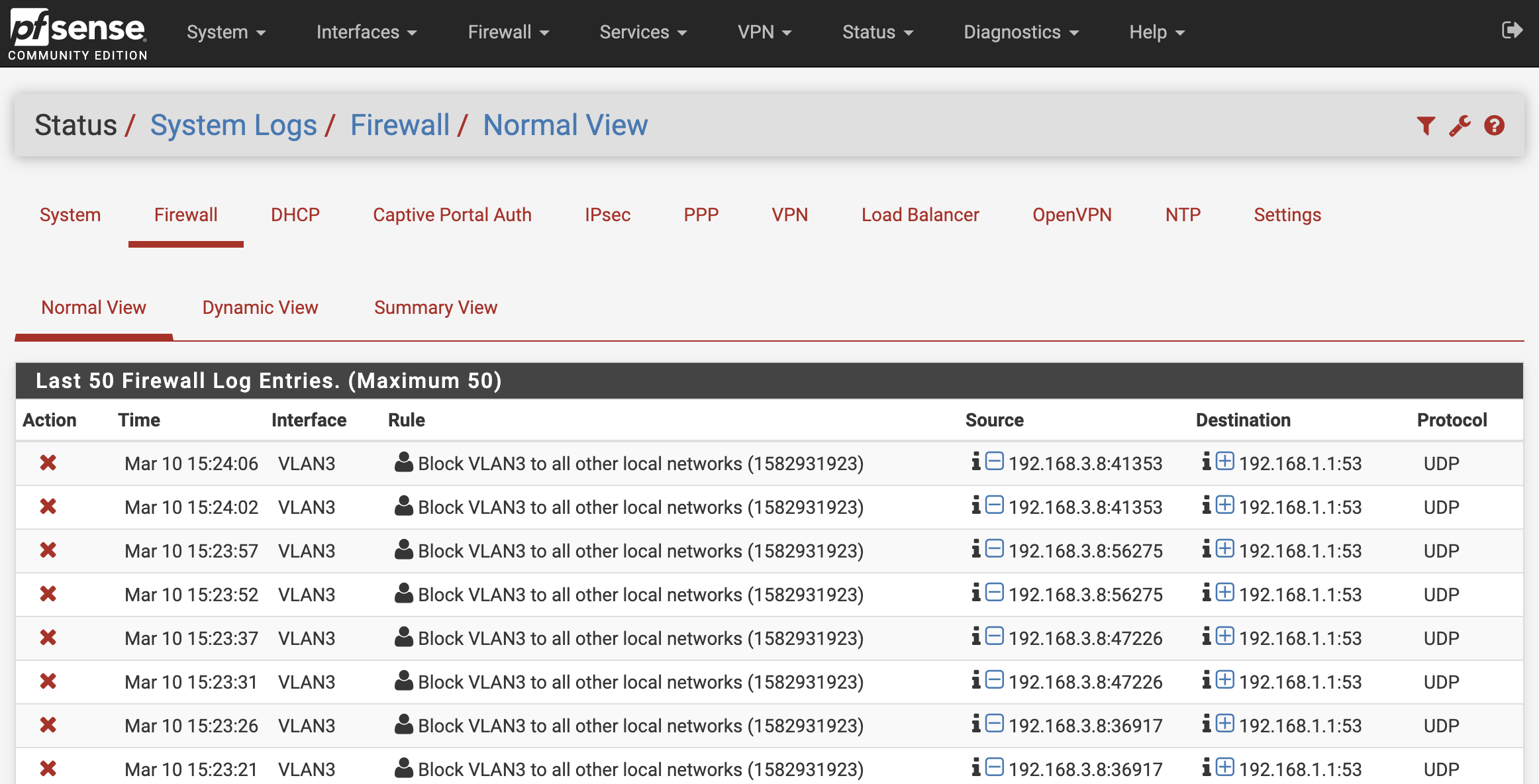

      I see that pfsense is blocking UDP requests from the ring doorbell pro to 192.168.1.1:53 and I don't understand why it isn't using 192.168.3.1 for DNS like all of the other IoT devices are.

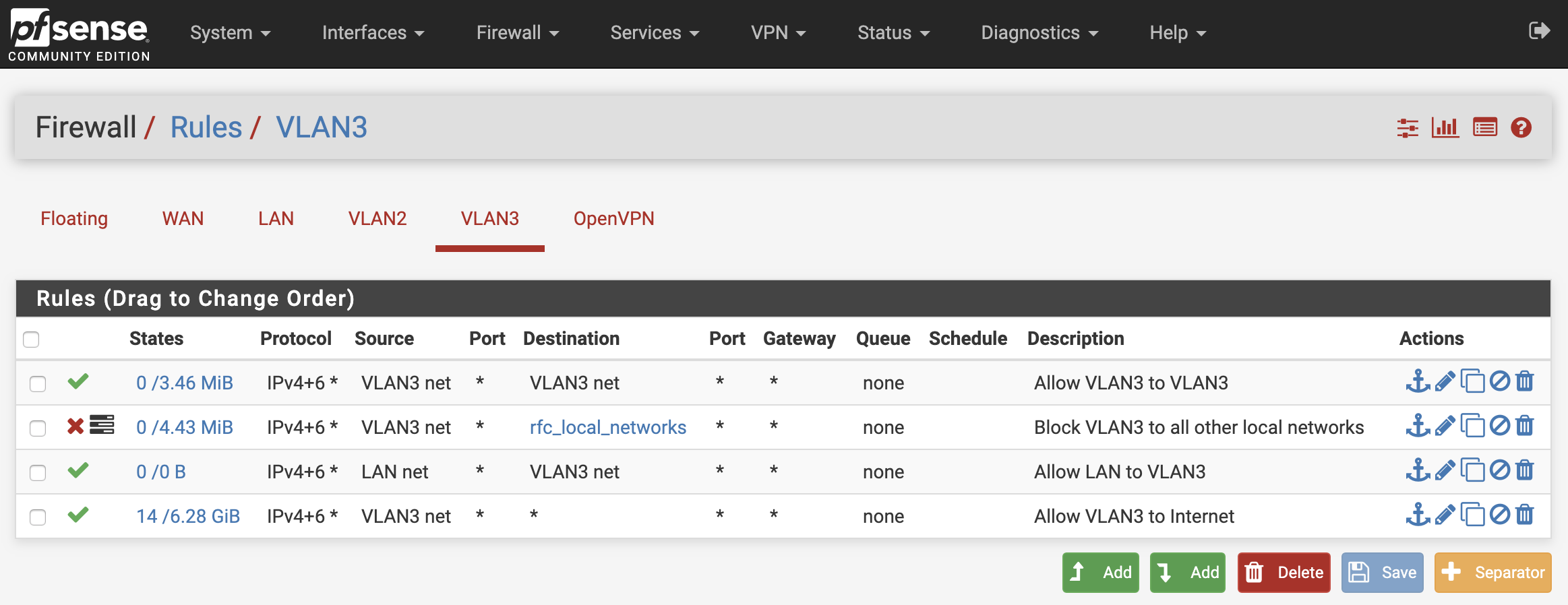

      My VLAN3 firewall rules are shown below:
      and a screen shot where pfsense is correctly blocking the VLAN3 to LAN connection attempt:
          Your "Allow VLAN3 to VLAN3" rule allows any access to pfSense! This is strictly not recommended on an interface which untrustworthy devices are connected to. There is no need for a rule to allow traffic between other VLAN3 devices, such traffic won't pass pfSense. So allow only, what you need, like DNS.
          The "Allow LAN to VLAN3" rule makes no sense on the VLAN3 interface at all. Rules on pfSense have to be defined on the incoming interface. So if you want permit access from LAN devices to VLAN3 devices, you have to put this rule on the LAN interface. To do so, just edit the rule and change the interface.

              @viragomann Hi, thank you for your reply and recommendations. I'll remove the VLAN3 to VLAN3 rule entirely, as well as the LAN to VLAN3... My LAN rules already allow any to any for LAN, so presumably that will allow connections from LAN to any other VLAN, correct?

                @jefftee said in Ring Doorbell Pro, VLANs, and DNS:
                Yes, any is really any. So that rule allows access to any address, inside your network or outside.

                  @viragomann Great, thanks for the recommendations! I have restarted my ring doorbell as I made changes, but I'll try again once I have made my firewall rule changes.

                    @viragomann I made the recommended changes to my VLAN3 firewall rules and once completed, I re-ran setup for my Ring Doorbell Pro... Seems to be working correctly now!!! I suspect in my many iterations of changes, I had not re-run setup on my Ring Doorbell Pro and it may have worked straight away had I just restarted it...
                    Thank you so much for your help!
