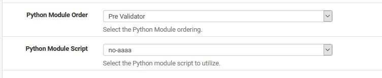

                    Grab that script that is linked too, put in a file called no-aaaa.py and copy that file to your /var/unbound dir
                    edit: btw - there are couple of ways to skin this cat if you don't care about just blocking this specific device from all IPv6 or nobody from resolving IPv6 for netflix... You can use simple private domain entry..
                    A GertjanG A 3 Replies Last reply Reply Quote 1
                      AberDino @johnpoz
                      @johnpoz said in BIND filter-aaaa:
                      I copped the script to /var/unbound.
                      That's the bit I was missing. All working beautifully now, thank you!

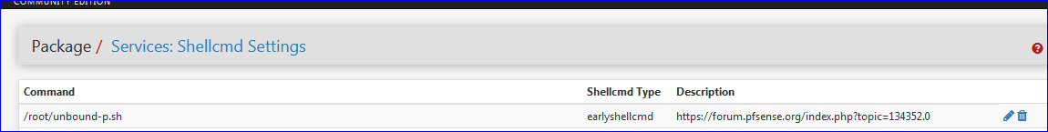

                        The thing is set up when pfSense starts using an earlyshellcmd command :
                        /root/unbound-p.sh is the script shown above.
                        It's placed in /root, together with the /root/netflix-no-aaaa.py script.

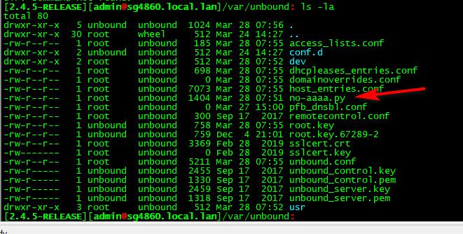

                                      AndrewZ @johnpoz
                                      Upgraded to 2.4.5_1 and noticed that this file [that was there for quite some time] - no-aaaa.py - is gone. Copied it over, rebooted and noticed that the file is gone again. Finally, realized that /var/ is mounted in RAM. So, where this file should be stored?

                                          2.4.5-RELEASE][admin@sg4860.local.lan]/root: cd /var/unbound
                                          [2.4.5-RELEASE][admin@sg4860.local.lan]/var/unbound: ls -la
                                          total 84
                                          drwxr-xr-x   5 unbound  unbound  1024 Jun 16 05:37 .
                                          drwxr-xr-x  31 root     wheel     512 Jun  2 16:54 ..
                                          -rw-r--r--   1 root     unbound   185 Jun 14 07:14 access_lists.conf
                                          drwxr-xr-x   2 unbound  unbound   512 Jun  2 16:54 conf.d
                                          drwxr-xr-x   2 root     unbound   512 Mar 28 07:52 dev
                                          -rw-r--r--   1 root     unbound   698 Jun 14 07:14 dhcpleases_entries.conf
                                          -rw-r--r--   1 root     unbound    65 Jun 14 07:14 domainoverrides.conf
                                          -rw-r--r--   1 root     unbound  6838 Jun 14 07:14 host_entries.conf
                                          -rw-r--r--   1 root     unbound  1404 Mar 28 07:51 no-aaaa.py
                                          -rw-r--r--   1 root     unbound     0 Jun 16 15:00 pfb_dnsbl.conf
                                          -rw-r--r--   1 root     unbound   300 Sep 17  2017 remotecontrol.conf
                                          -rw-r--r--   1 unbound  unbound   758 Jun 16 05:37 root.key
                                          -rw-r--r--   1 unbound  unbound   759 Dec  4  2019 root.key.67289-2
                                          -rw-r--r--   1 root     unbound  3369 Feb 28  2019 sslcert.crt
                                          -rw-------   1 root     unbound     0 Feb 28  2019 sslcert.key
                                          -rw-r--r--   1 root     unbound  5297 Jun 14 07:14 unbound.conf
                                          -rw-r-----   1 unbound  unbound  2455 Sep 17  2017 unbound_control.key
                                          -rw-r-----   1 unbound  unbound  1330 Sep 17  2017 unbound_control.pem
                                          -rw-r-----   1 unbound  unbound  2459 Sep 17  2017 unbound_server.key
                                          -rw-r-----   1 unbound  unbound  1318 Sep 17  2017 unbound_server.pem
                                          drwxr-xr-x   3 root     unbound   512 Mar 28 07:52 usr
                                          [2.4.5-RELEASE][admin@sg4860.local.lan]/var/unbound: cat no-aaaa.py
