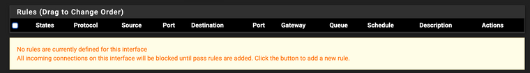

                      pfSense A firewall Rules for OpenVPN: (those rules were created by the OpenVPN creation wizard)

                      • GertjanG Online
                        Gertjan @cneu88
                        @cneu88 said in Port Forwarding through VPN:
                        pfSense B firewall Rules for OpenVPN: (those rules were created by the OpenVPN creation wizard)
                        and pfSense A should have to same Wizard created rules on the it's interface.
                        You have none , Then no VPN server is possible.
