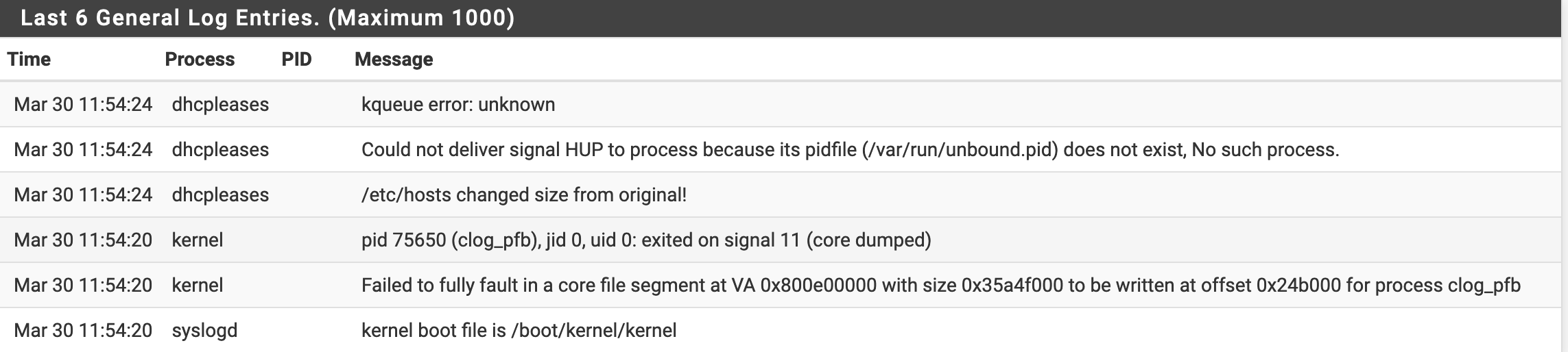

        • ? Offline
          A Former User
          I use tail -f all the time.
          Reset the log files just a moment ago.
          • BBcan177B Offline
            BBcan177 Moderator @Guest
            @jwj said in clog_pfb drops a core if system log files are reset:
            I have no idea if this is 2.4.5 specific or not. Never reset the log files until 2.4.5 while trying to get a handle on the latency/packet loss issue.
            I tried to reset on my test pfSense 2.4.5 VM in ESXi and had no issue resetting the logs... Maybe this is related to the other issues? Are you in a physical box or a Virtual machine? Details?
