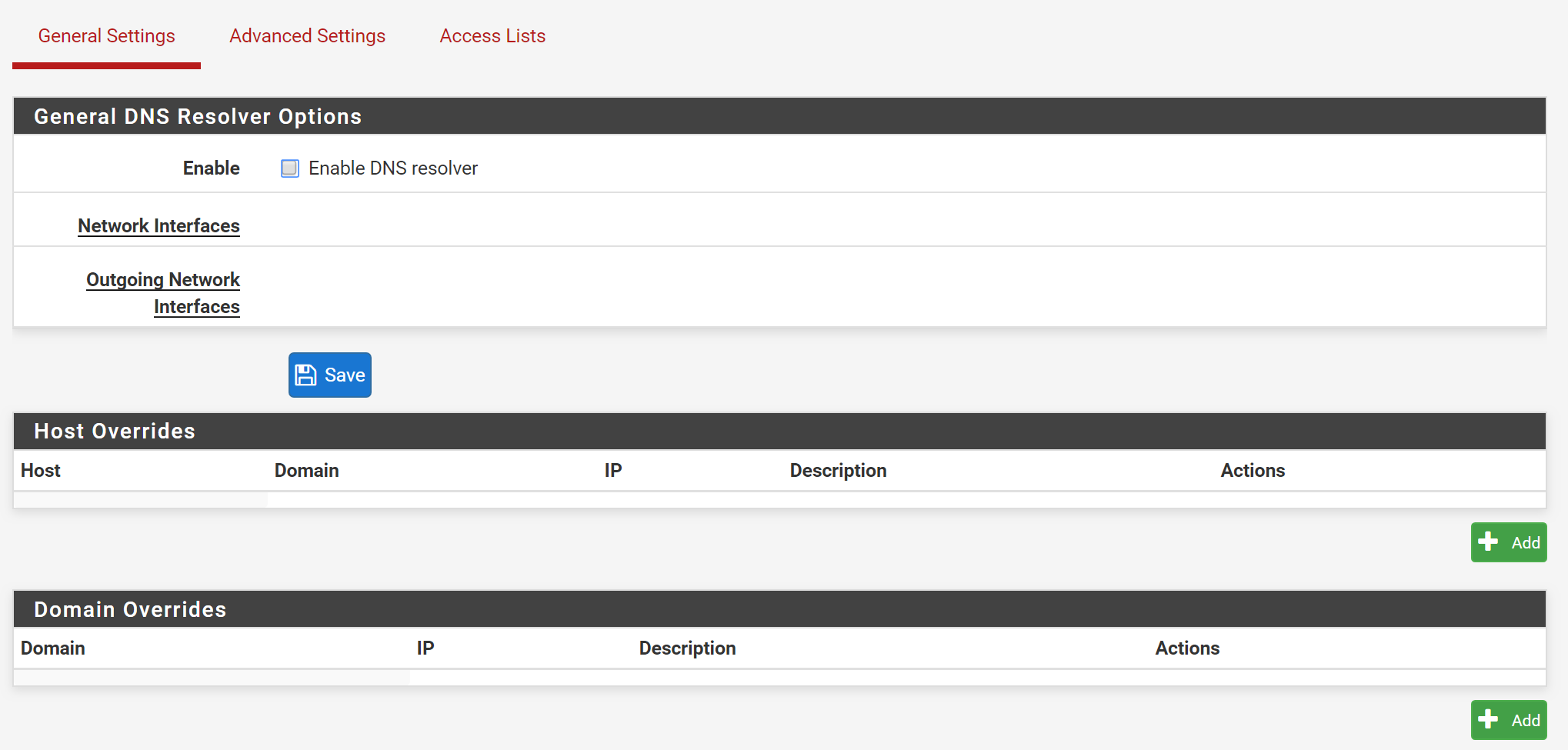

                            • A
                              albertmiclat @jimp
                              @jimp looks like DNS resolver is not enabled, can i still proceed to add the ACL or this must be enable first?
                              • jimpJ
                                Are you using the DNS Forwarder then?
                                Or what are the clients using for DNS if not the firewall?
                                Do not Chat/PM for help!
