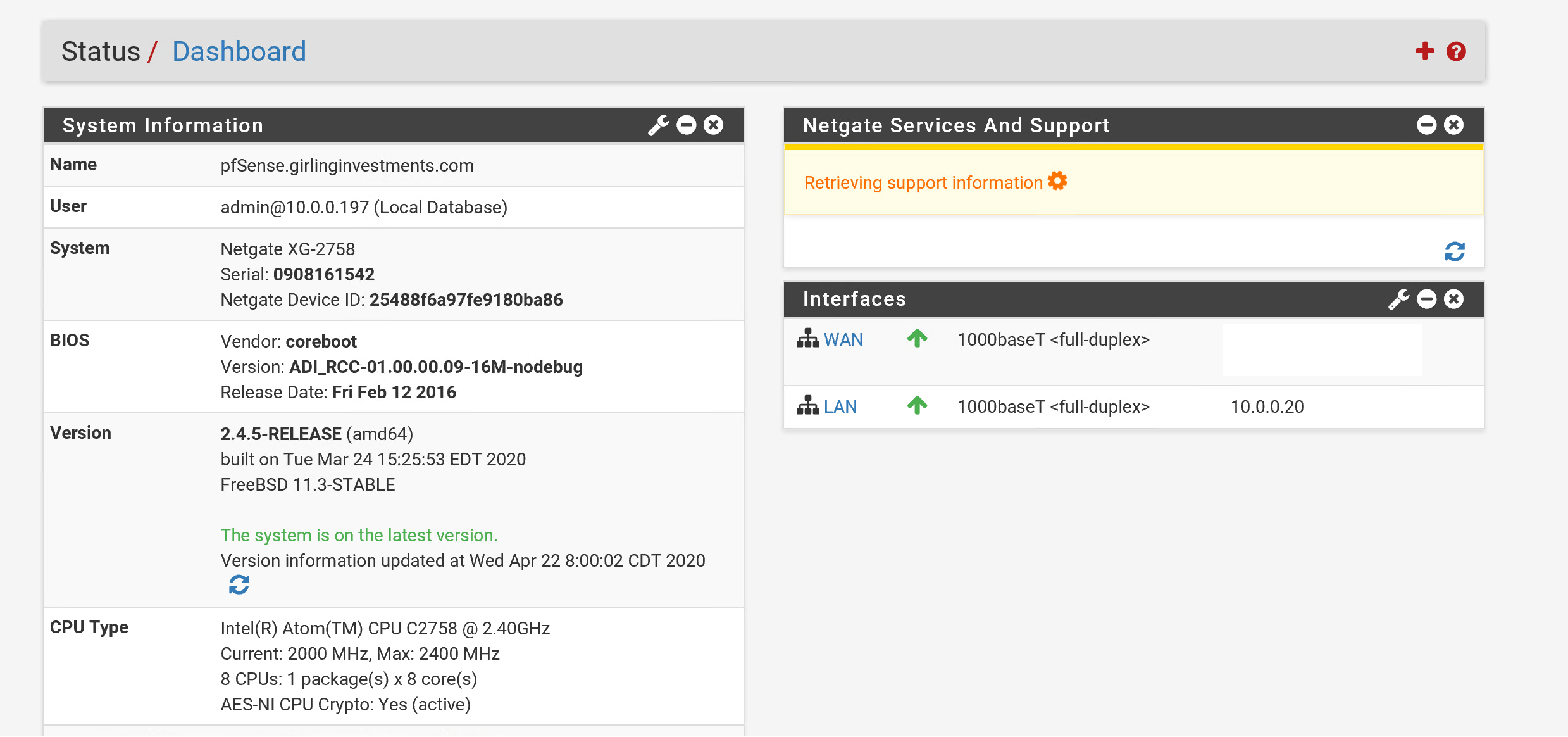

                                          Sorry for the delay guys. I've been swamped and just now able to get back to this.
                                          The LAN and WAN links show link lights
                                          WAN pulls an IPv6 address from DHCP but not IPv4 so I set it to static
                                          ARP table shows a MAC from the upstream first hop router with the ISP
                                          Dashboard shows both interfaces as UP... Still unable to ping outside
                                          WAN IP is not missing its just been redacted on this screenshot
                                            Does it pull a real, routable IPv6 address? Can you ping6 out of it?
                                            But you cannot ping the first hop device using whatever IP it appears as?
                                            Are you sure you're using the correct IP and gateway info?
