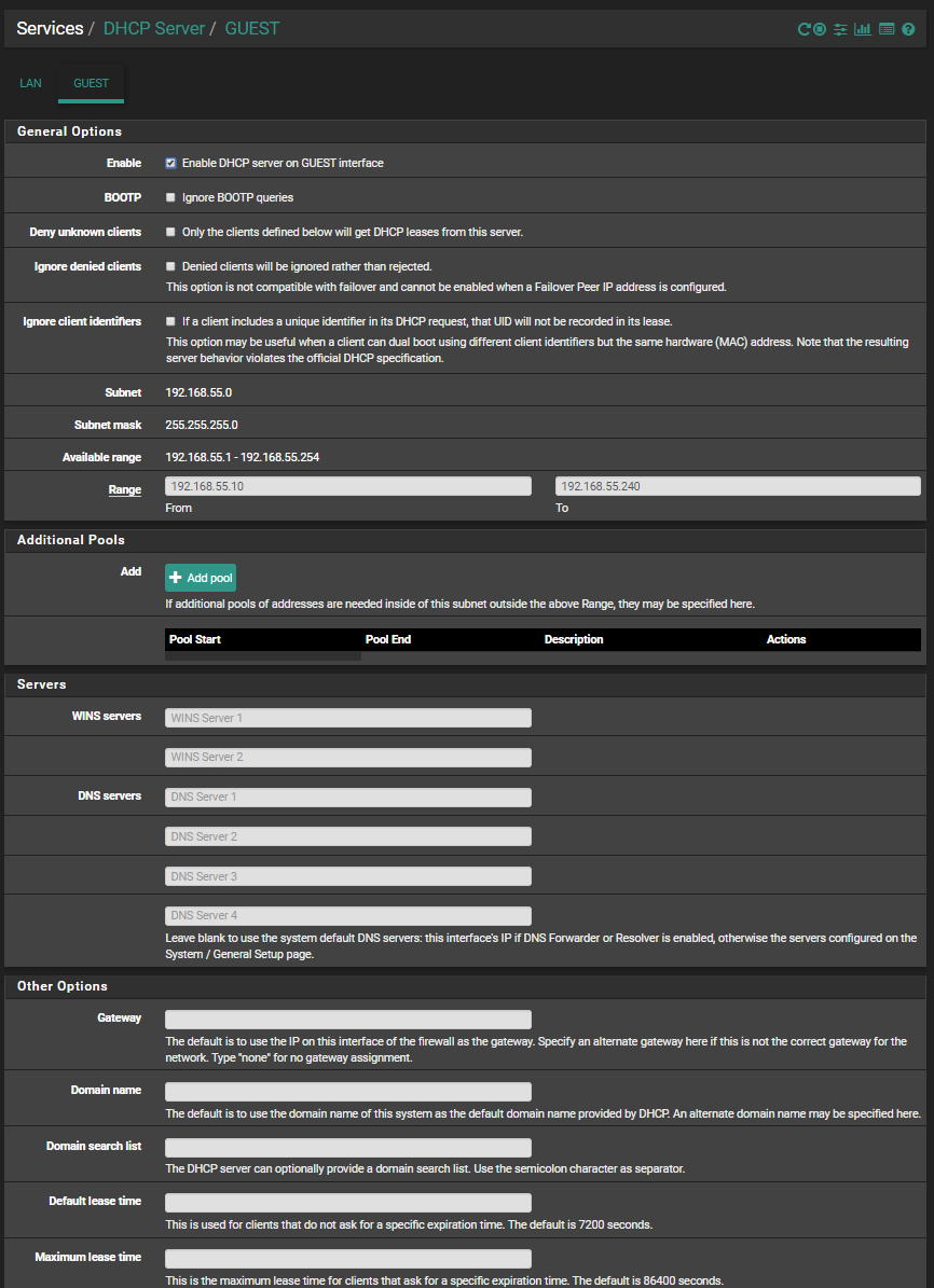

      VLAN DHCP service:

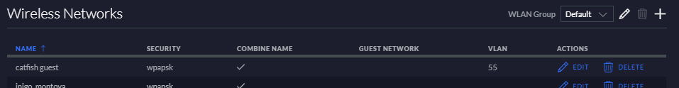

      Unifi networks:
      Unifi WIFI networks:
