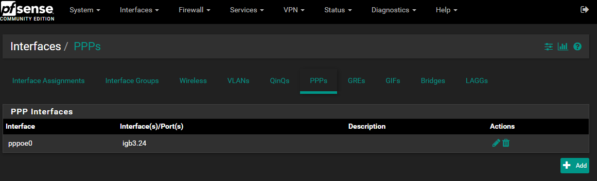

      Hi, ill start saying im fairly new to pfSense, ill explain my prolem, I had configured pfsense this way ISP->ONT->pfSense, the problem I have is that after setting the VLAN to 24 (it might be this because im from spain using and OMV called FiNetwork and this ISP uses Lowi's ISP which for NEBA is 24, not 100% sure about this one), than I created a pppoe interface with the hostname and password that I got from a friend that works for that ISP, after setting them in and pointg this interface to the vland24 I've just created it appears down. I'll attach pictures for that.
      If you need more screenshot for other things just ask for them and im glad to provided as many as it needs.
      Thanks so much for any bit of helped involed, if you know something please don't hessitate to share it with me as im kind desperate on this.

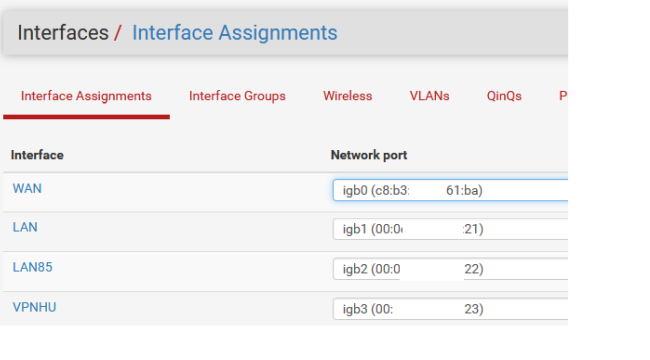

                I see that there is a Dell (vendor) MAC address in the interface list as a WAN interface. (I don't think this is the ISP CPE)
                if the MAC spoofing is successful, you can see the MAC of the old / ISP router here
                I think MAC spoofing failed, because you need to show something like this with different MAC addresses within a device....
                this is a 4 eth. port on APU device with spoofed MAC address on WAN (with Cisco MAC)

                  your PRTSC is show that, you have all interfaces on b8: ca: 3a: ........ this a DELL NIC

                        @DaddyGo Don't worry im so thankfull for your time, im just getting the think you asked me, I managed to get to work de MAC spoofing, now im gonna test if the ONT get's the ip into the router.

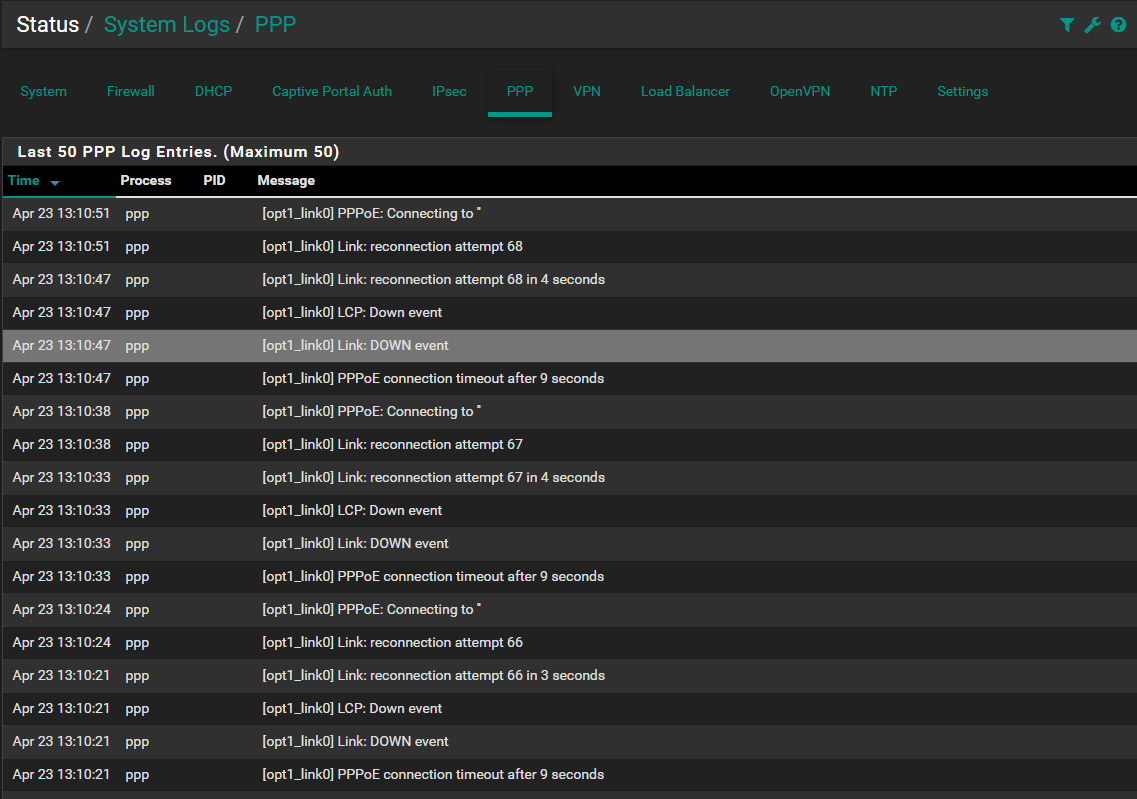

                          @DaddyGo Okay, we made progress, now my ONT starts blinking on the lan side, it seems that it's trying to do something, also the PPPOE conecction goes up than goes down, give a moment and ill make a screenshot of the DHCP logs.

                                          @DaddyGo Back at work hahaha, I changed the time, this is the DHCP log is showing up, ill link the pictures throught drive because it's faster than taking a screenshot and uploading since only my laptop has an internet connection (https://drive.google.com/open?id=1-1ooMoEYBpKMLVECANBQ9Hvi2wyp3y8d) that's what DHCP is showing.

                                            • the following should be observed in the dhcp log.... from WAN
                                              but in front of it press a button on the status / interface tab, WAN section "release WAN" / with this button we start a process which, if we are lucky, generates a log entry in dhcp
