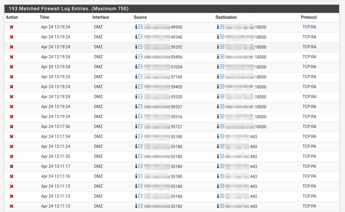

      I am seeing tons of traffic being blocked in the FW logs even if I have rules setup to allow such traffic.

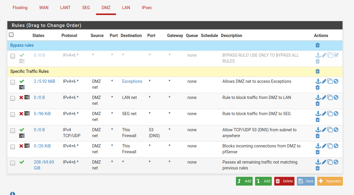

      This happens on a "DMZ" interface which is designed to block traffic going to the other interfaces, but allow anything else.
      Rules are setup as follows:
      1. Allow traffic to some hosts (exceptions), these are printers, scanners, etc. Using an alias.
      2. Block any kind of traffic going to LAN interface
      3. Block any kind of traffic going to SEG interface
      4. Allow TCP-UDP on Port 53 going to pfsense (so hosts on DMZ can use DNS)
      5. Block any kind of traffic going to pfsense (to minimize chances of compromising pfsense)
      6. Allow anything else.
        Eveen with the last rule, the logs arre filled with blocked traffic on DMZ. The rules setup has NOT changed in several months, and this week I started experiencing severe connectivity issues on clients connected to DMZ.
      The blocked traffic shows descriptions such as
      @9(1000000103) block drop in log inet all label "Default deny rule IPv4"
      What would be the root cause of this?
        Out of state traffic most likely, asymmetrical traffic flow, etc..
        https://docs.netgate.com/pfsense/en/latest/firewall/troubleshooting-blocked-log-entries-for-legitimate-connection-packets.html
        You got a bunch of RA there, and PAs

          1. Out of state, asymmetrical, etc.... I am pretty sure that I didnt use to see RA & PA packets like these... But I may be wrong. Is it anything to be concerned about?

            OK did some more tests.... and found some interesting stuff.
            1. Seems like more than one client on DMZ will cause similar entries in pfsense's firewall logs. At least, I know this is not isolated to a single machine.
            2. When one of these client (laptop) is connected to DMZ via wired connection (using ports 23 or 24 of my Procurve switch), I dont see any RA, PA or TPA log entries... EDIT: False... I just refreshed the logs and still see tons of these entries while laptop is wired.
