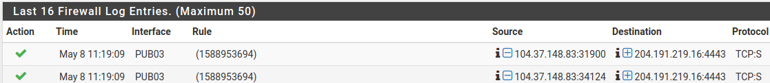

                        I substituted that for the real address. I've attached the unedited output of the firewall log. PUB03 is the WAN. The Source and Destination addresses in the log match the public IP addresses of my socks proxy and pfSense WAN, respectively.firewall_log.png

                                I think I have this solved, partly. One of the disconnected interfaces on pfSense is in the same subnet as 104.37.148.83, so that's maybe going to cause a problem, although I don't see replies going out that interface, maybe because it's disconnected.
                                The other mystery is why disabling the rfc1918 filter causes the wan to be reachable from that subnet.
