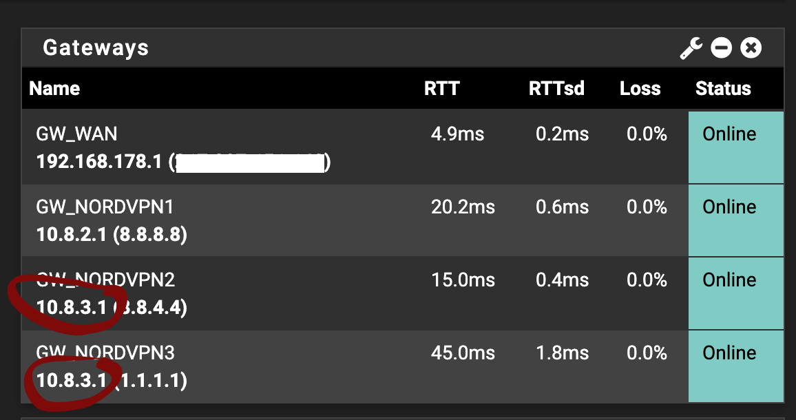

    I am using multiple openVPN clients to do load-balancing with NordVPN. The crenditials and ports used to connect are the same for all clients, only the server IP is different. This seems to cause the gateways ending up having the same Gatway IP. NordVPN sadly provides only 1194 port for UDP.
    Anyway to make the Gateway IPs unique?

        The gateway IP assignment is not on your side, it's preset by the server.
        If you want to have redundant VPN connections ask your VPN provider for proper servers, find it out by yourself or use different VPN providers.

          My VPN provider does provide multiple servers but as I am connecting to several of them, the subnets are overlapping.

              I thought the public IP (185.220.xxx.xxx) that the server provides me is enough for the server to communicte with me and that the Virtual IP and Gateway IP are something purely local to me and I can set it myself. I now understand that these IPs are something that the VPN Server hands out to its clients and is the way for the server to communicate with the client (and back). Is this right?
              So it absolutely does not make sense that I set it and expect that the server will "find me". I noticed that, after I setup the routing table, Virtual IP and Gateway IP with the above steps, data was going out into the tunnel but never coming back. This explains why the gateway was down.
              What I am trying to do, as I mentioned in my initial post, is to prevent duplicate Gateway IPs when I connect to different servers (of the same provider). As of now, after a pfSense restart, I connect and disconnect the VPN clients with the duplicated IPs and after 2-3 tries it gets an IP from a different subnet. I guess I will have to live with this workaround.
