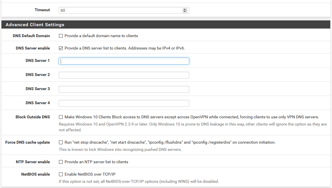

                    My screenshot is showing the OpenVPN server options...
                    -Rico

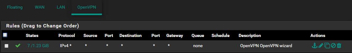

                            DNS traffic to pfSense is allowed with Firewall Rules?
                            Can you post your Rules via screenshots?
                            -Rico
                            x2rlX 1 Reply Last reply Reply Quote 0
                            • x2rlX Offline
                              x2rl @Rico
                              @Rico Thanks here are the rules
