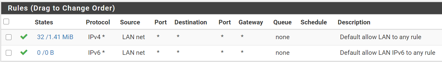

      I was under the impression that the default LAN rule (below), would allow me to access the other interfaces.

      • I want to access the switch’s management interface (done through web browser) from LAN. I can already access the management console from a computer on VLAN 10 but I want direct access from my computer on LAN. Am I missing something in the Firewall rules on the LAN side? Do I need to define a rule on VLAN10?
