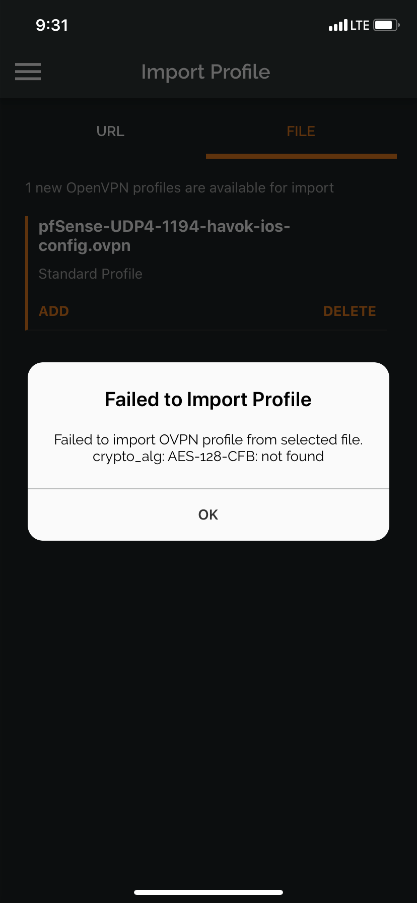

      Hello, I am at wits end trying to get my openvpn client to connect to my PFSense firewall.
      I have completed the guide here: https://docs.netgate.com/pfsense/en/latest/vpn/openvpn/openvpn-remote-access-server.html
      when i attempt to import the vpn profile on my iphone, i get what is shown in the screen shot.

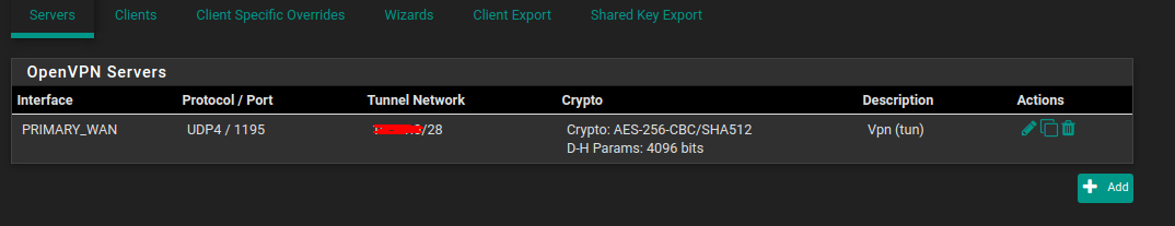

      I have tried several different crypto algorithms but nothing seems to work. i have verified that the openvpn service is running on PF Sense seen here:
      and here is a snip of the crypto config server side.
      Can someone please help!
      • viktor_gV Offline
        viktor_g Netgate
        probably iOS openssl library doesn't support that cipher,
        try to use AES-128-CBC in the Encryption Algorithm field

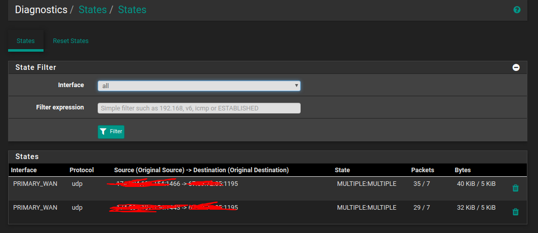

            • H Offline
              havockk
              packet capture from WAN interface:
              18:13:24.100702 10:e8:78:e0:21:d8 > 40:62:31:0a:71:c8, ethertype IPv4 (0x0800), length 128: (tos 0x0, ttl 53, id 28697, offset 0, flags [none], proto UDP (17), length 114)
              [client wan address].1464 > [server wan address].1195: [udp sum ok] UDP, length 86
              18:13:24.100942 40:62:31:0a:71:c8 > 00:12:1e:22:a3:f0, ethertype IPv4 (0x0800), length 140: (tos 0x0, ttl 64, id 51957, offset 0, flags [none], proto UDP (17), length 126)
              [server wan address].1195 > [client wan address].1464: [udp sum ok] UDP, length 98
              When I attempt to capture packets on the openvpn interface, no information is in the output.
              Is this enough information?

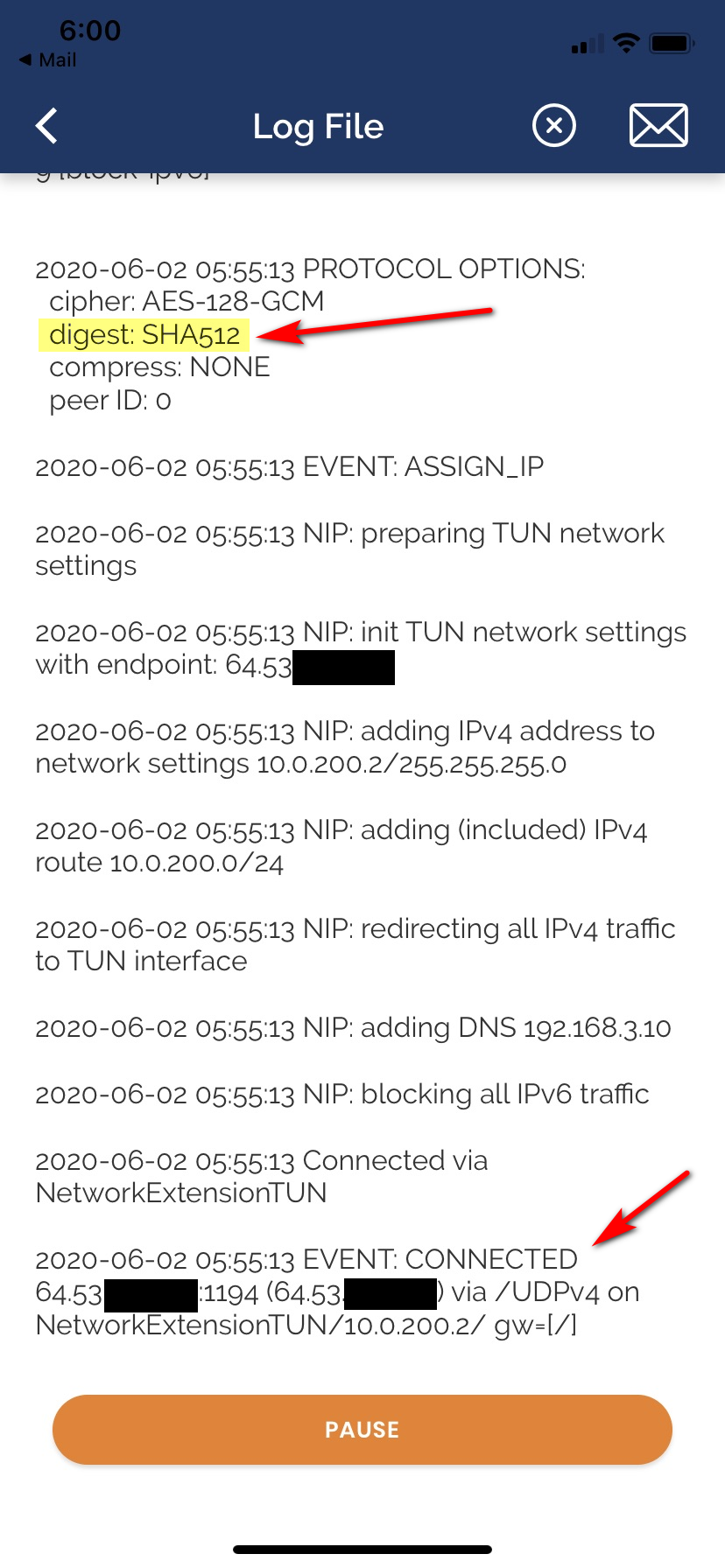

                        • johnpozJ Online
                          @Rico said in OVPN export to iOS fails:
                          Maybe there is a problem with auth SHA512 and iOS?
                          No since I just set it and worked just fine..
                          iphone XR running 13.5.1 with openvpn connect 3.1.2 (3096)
                          persist-tun
                          persist-key
                          cipher AES-128-CBC
                          ncp-ciphers AES-128-GCM:AES-192-GCM:AES-256-GCM:AES-128-CBC:AES-192-CBC:AES-256-CBC
                          auth SHA512
                          tls-client
                          client
                          remote 64.53.x.x 1194 udp4
                          verify-x509-name "pfsenseopenvpn" name
                          remote-cert-tls server
