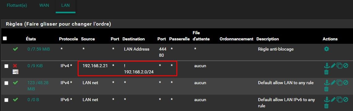

      Hello,
      Freshly migrated from Ipfire to pfSense, but still have an issue:
      Simple use case :
      I want to block traffic from LAN to WAN for a ip (192.168.2.21) to an ip google.fr (172.217.23.163)
      For all protocols (in this case i use ICMP (ping) for testing rules)
      • First try (with WAN net as target ,supposed to be WAN network)
      Fails (Nothing in the fw logs)
      • Second try (with WAN adress as target ,supposed to be WAN adress group):
      • Third try (with this firewall):
      • Fourth try (with ip of google 172.217.23.163)
        Great, works, we're approaching !
      • Fifth try (with negation of 192.168.2.0, after my own exorcism)
        Great, works too.
      • Sixth and last (with all)
        Great, works too.
      So my question is, why cases 1 and 2 are not working ?
      There's probably a good reason, but i want to know why, (i have working solutions, but for me cases 1 and 2 are more naturals, this is what i implement in my old ipfire).
      Thank you !
      Fred

          Thank you John for your response.
          WAN is just the WAN interface part (I understand).
          What are the best practices for my use case ?
            Gertjan
            Use 'any' as a destination.
            This won't stop 192.168.2.21 from pinging all device on it's own LAN - something you can never stop, but not pfSense or elsewhere, higher up.
