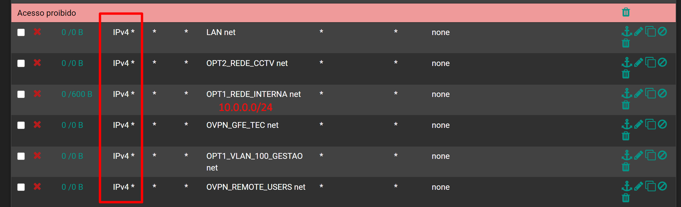

    This is the classic case of a guest network, where its suppose to have internet access, but not to other local networks in general, only to certain devices:
    But seems like its possible to access to all the permited mail services but not that NAS 10.0.0.5 at all (I tried previously with ports 80 and 8080 and nothing) with the yellow rectangle.

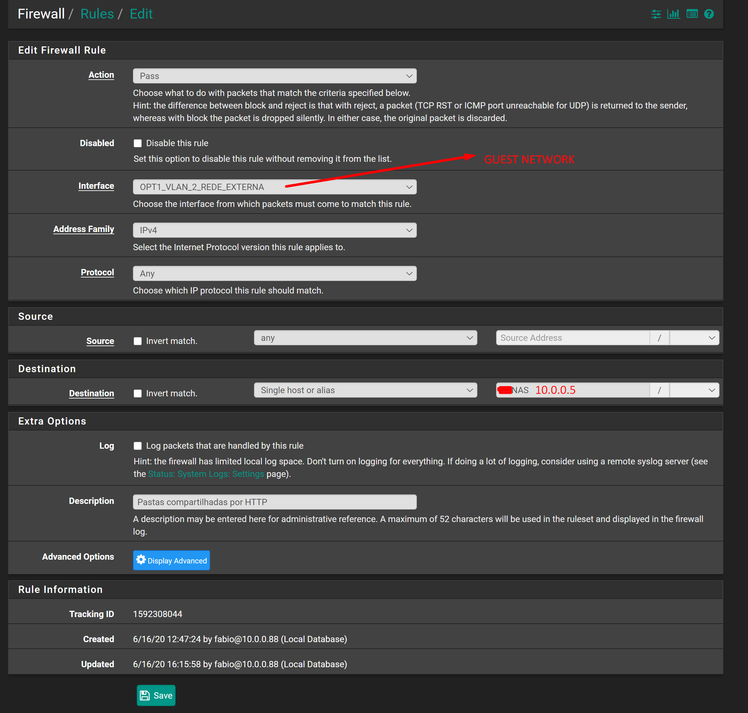

    This is how the rule is setup:
    I really dont know why I cannot access that device, not even through ICMP PING.
    Note that I can access from another network (an OpenVPN) to this device, without problem, and the device can reach internet and communicate with the rest of the network 10.0.0.0/24 where is it.
    Anyone here knows what I am missing here?!
