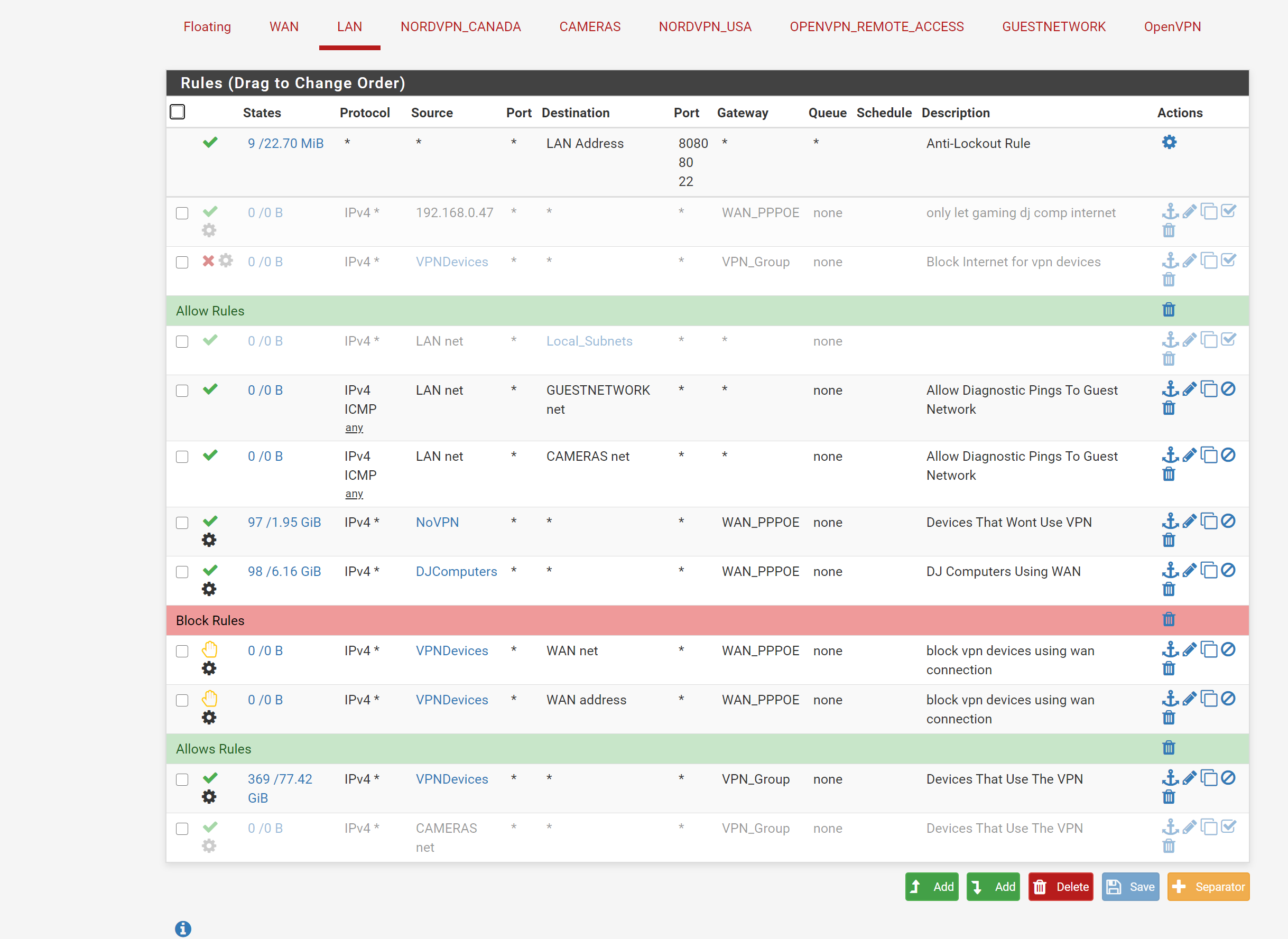

                          @viragomann so here are some screen shots of my rules and nat
                          what other settings would you need to see to see whats wronglan rules.PNG nat outbound.PNG ![nat portforward.PNG](wan rules.PNG

                                  Your screenshots don't show any portfrowarding.
                                  @comet424 said in what do i need to setup to direct different domain names to IPs on my network:
                                  Port Forward 80 goes to 192.168.0.30 and on the Same screen shot you see i have it setup Port Forward 3000 goes to 191.168.0.3.
                                  These are firewall rules!
                                  Portforwarding is done in Firewall > NAT > Port forward.
