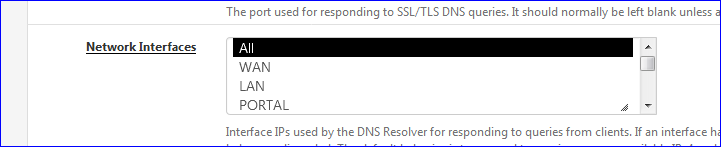

        Is the pfSense Resolver set up to listen on this interface ?
        This setting :
        handles this question just fine.

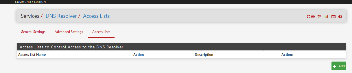

        Resolver settings : you're not using CL settings ?
        These :

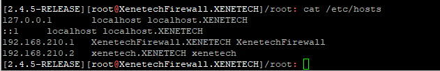

        Also : does the pfSense Resolver actually contain the local host names ?
        Execute
        cat /etc/hosts
        to find out.

                  Yes the Network Interfaces is set to All
                  I'm not using CL Settings
