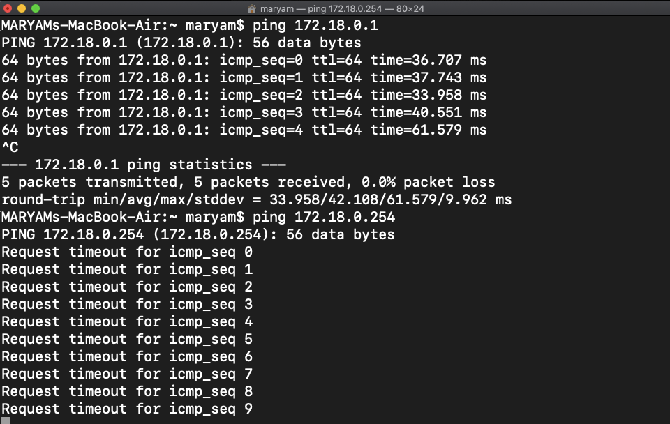

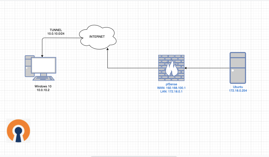

      After connect VPN, I can ping to local gateway (172.18.0.1). But, I can't ping or access my server (172.18.0.254). Why, anyone can help me???

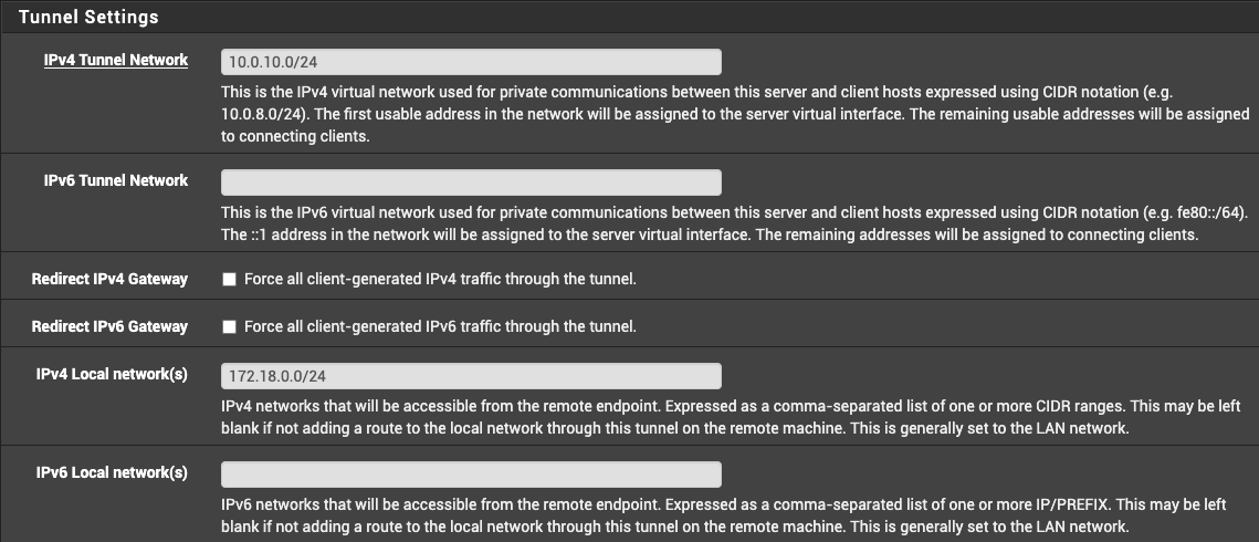

      This is my pfsense configuration:

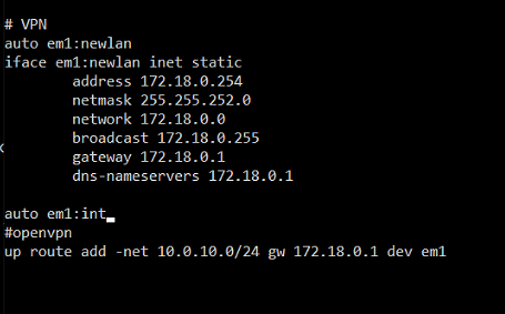

      This is my ubuntu server:

        Possibly the servers firewall blocks access from outside its subnet.
        Since you're running the OpenVPN server on the Ubuntu servers default gateway, there is no need to add a route for the VPN tunnel network.

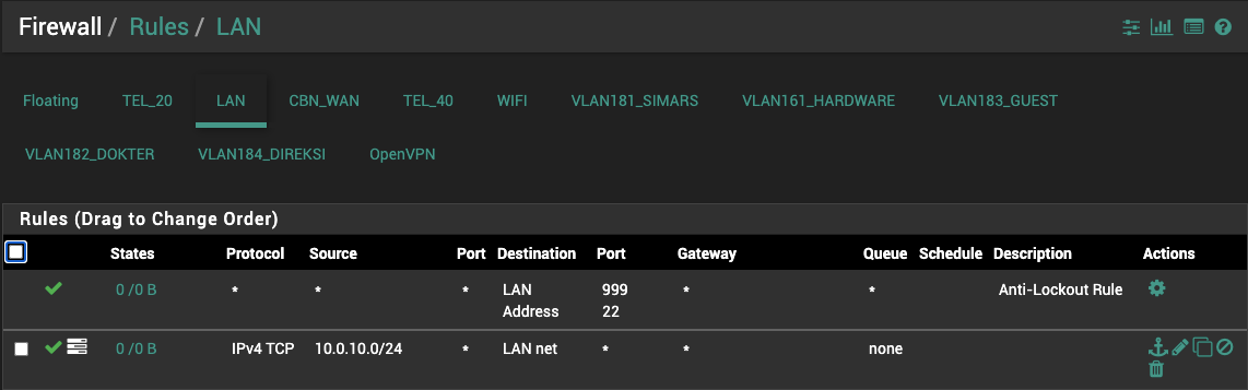

              @viragomann already add rule on my LAN network, is tha true?

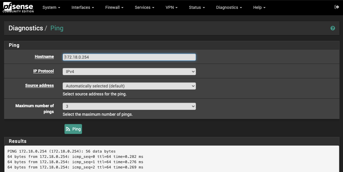

              • V Offline
                viragomann @ontzuevanhussen
                @ontzuevanhussen
                A simple test: on pfsense go to Diagnostic > Ping
                Try to ping the Ubuntu servers IP.
                Then change the source to something else like WAN or OpenVPN. Ping again.

                • ontzuevanhussenO Offline
                  ontzuevanhussen @viragomann

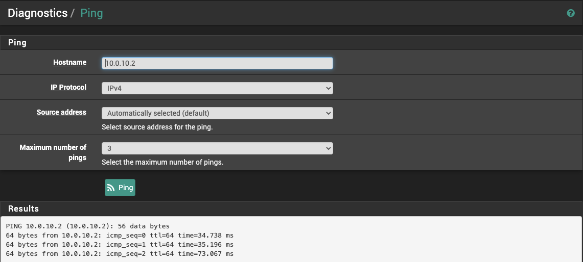

                  @viragomann Ping to my ubuntu server
                  Ping to my client VPN:

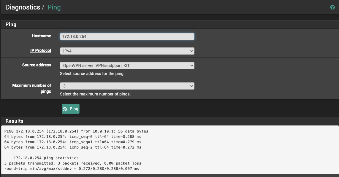

                  • V Offline
                    @ontzuevanhussen
                    Not ping the VPN!
                    Ping the Ubuntu and set the source to OpenVPN!

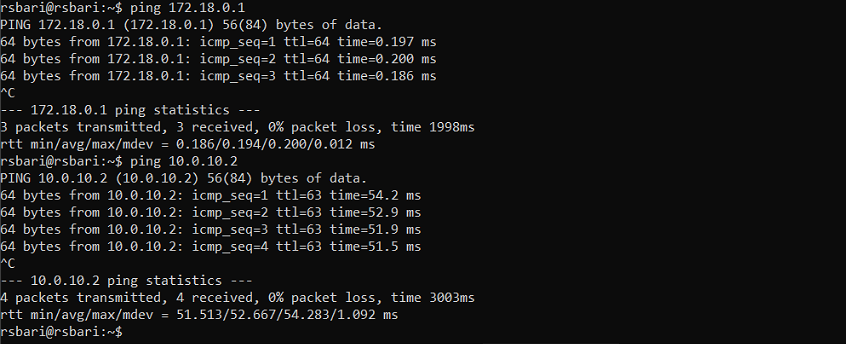

                      Ping from ubuntu server to gateway and vpn client:
                      • V Offline
                        @ontzuevanhussen
                        Ok. I give it up.
                        ontzuevanhussenO 2 Replies Last reply Reply Quote 0

                              ontzuevanhussen
                              Request timeout for icmp_seq 266
                              76 bytes from xxx.xxx.xxx.xxx: Communication prohibited by filter
                              Vr HL TOS Len ID Flg off TTL Pro cks Src Dst
                              4 5 00 5400 7348 0 0000 40 01 464f 10.0.10.2 172.18.0.254

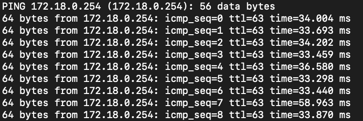

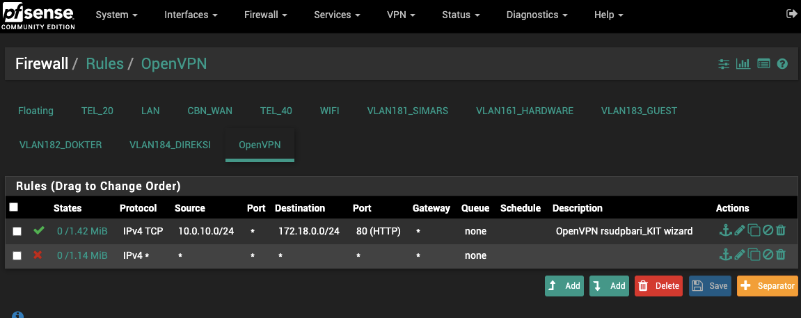

                                @viragomann Ok, done. Now everything works normally.
                                Because of the rules in the VPN tab:
