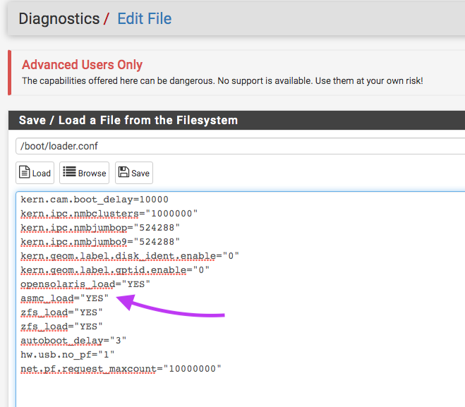

                      Don't know whether the OP is still here; however, I have added the asmc.ko module, rebooted, and update with daily snapshot without any issue. The hardware management tool that comes with FreeBSD - IPMI ... somehow I could not get it to work with the asmc.ko module nor with the ipmi.ko modules. It seems that it was expecting the ipmi.ko modules to be in /usr/src/sys/modules/ ... Src is intentionally left empty which suggest one of the changes made to FreeBSD 12.1. So, I'll download the Apple smc fan controller and give that a try over the weekend.

                        With asmc loaded you should see some sysctls that relate to the settings available. sysctl dev.asmc
                        Also check the boot log to see if it attached to anything. Or load it after boot with kldload and then check the system log.
                        Also you should put custom loader variables in /boot/loader.conf.local otherwise they may all be overwritten.
                        NollipfSenseN 1 Reply Last reply Reply Quote 0

                          Well Steve, it seems that I didn't carry out your instructions carefully ... I had downloaded and extracted from FreeBSD 12.1 RELEASE instead of FreeBSD 12.1 stable. I gathered that from the following images below. I will redo later. I didn't fine the file /boot/loader.conf.local
