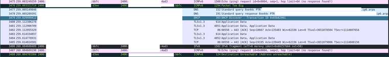

      I'm having an odd issue with IPv6 fragmentation. My LAN connections are all ethernet, any my WAN connection is via PPPoE with a MTU of 1492 (and MSS clamping set to 1452 as per my ISP's instructions).
      When I try to ping an external host with
      ping -6 [host] -s 1444
      everything works fine (as expected), and wireshark reports that the outgoing ICMPv6 echo request has a length of 1506 bytes, i.e. 1492 after the 14 byte ethernet header is accounted for. When I increase the size to above 1444 I receive an ICMPv6 Packet Too Big message from the internal pfSense interface (again, as expected), and the subsequent ICMPv6 echo request packet is fragmented into one with a length of 1502 bytes and one with a length of 76 bytes - however now I get a more generic ICMPv6 Destination Unreachable error (bbfc is my computer, d4ee is pfSense, 4ad3 is a remote Linode instance).
      I tried again with scrub disabled in the advanced options - this did not help.
      I then (temporarily) disabled pf - and the problem went away.
      After re-enabling pf the problem returned. I made sure that the default deny rule was logged, and then set all of my blocking rules to log. I validated this by running
      grep block /tmp/rules.debug | grep -v log
      (i.e. lines which contain block but not log) in the command prompt and the only lines returned were comments. I looked at the firewall log after testing again (with an ICMPv6 packet size > 1444) and the packets showed up as being passed.
      I then modified /etc/inc/filter.inc, firstly to create a blank rules.debug (no traffic was passed, as expected), and then to create only "pass out all" (or something similar - I can't remember exactly) and all traffic was passed (as expected), including IPv6 fragments.
      This lead me to believe that pf is the culprit somehow, as it doesn't appear to be a MTU or PMTUD issue if it works when pf is disabled.
